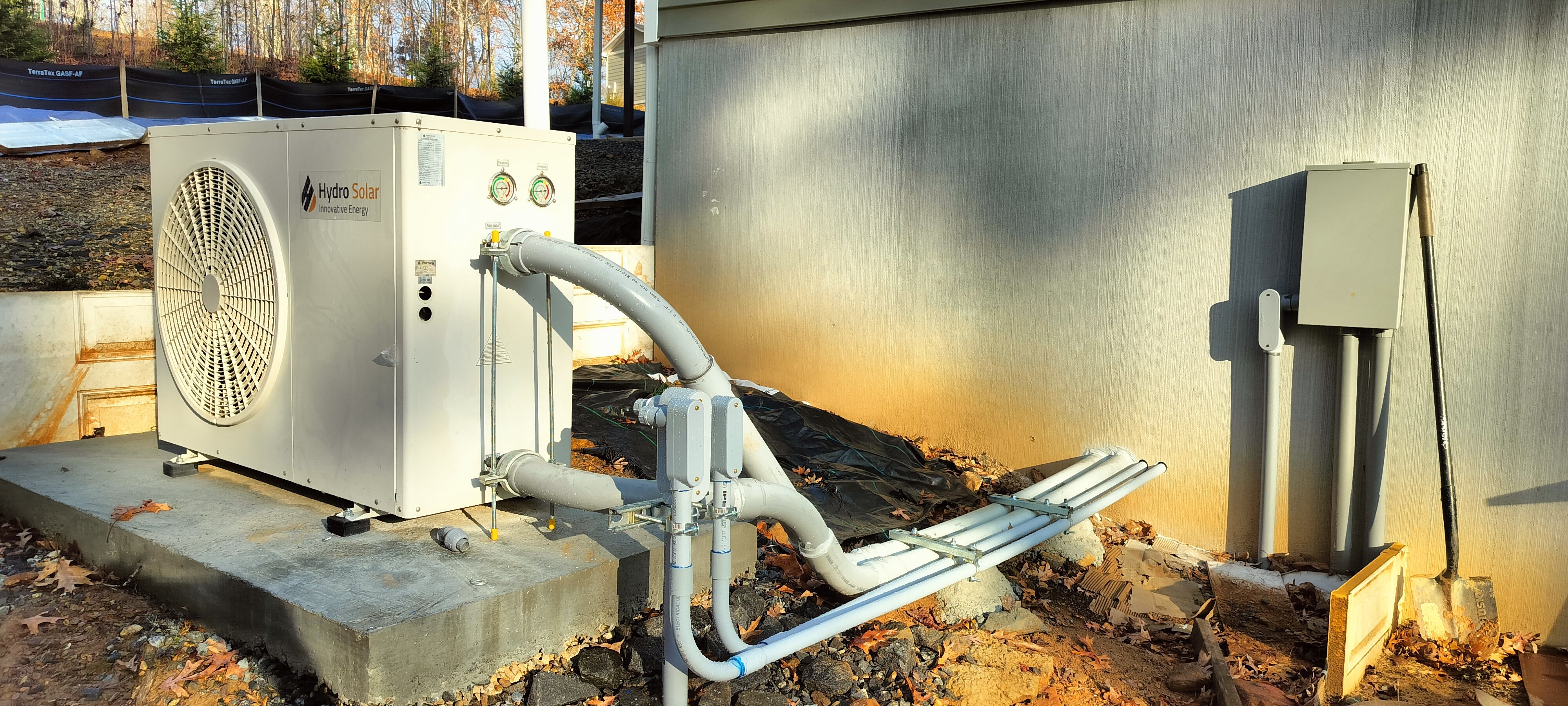

    I don't know if you have purchased your unit yet, I just came across your post. I am currently installing one of these in the North Georgia mountains. It will be an all three function installation providing,Heat/ Air/ DHW.
    It is a A new construction build, I have coupled it with PEX in concrete basement level,staple up transfer plates on the main level of this ranch house to facilitate the heat load. The AC load will be forced air through a first air water coil forced air handler. Due to the humidity I will incorporate a April Air 80 pint per day dehumidifier in the central system along with a fantec ERV system. I specified and purchased the unit when designing the construction so we are still in work it has been sitting in a crate until recently. If you are not in a hurry I can get back to you with more information once I get the system up to speed.
    Your right The price was right and because it is my own I decided to take a chance on it. My first impression is the technology is tried and true meaning the compressor is Panasonic the other components have been on the market for years. I will tell you that their manuals have a lot of technical information but not much in the way of installation and no available training videos online. If you are doing this yourself you should be well versed in hydronics.
    I would also add that if you can turn on a unit basically have a brace plate heat exchanger free on the water and understand pumps and switches etc you can pretty much cobble a system out of almost anything. And with today's pumps like the VT 2218 if you are are able to get hot or chilled water into a tank and create an energy battery of some kind now all you have to do is pump to the delivery whether that be air handler or heat emitter of any kind sizing the emitters and the air handler and proper ducting in my eyes are the biggest design issues The outdoor unit is common sense otherwise plug in a boiler and call it a day. I only went with this unit because of the fact that natural gas is not available in my area and I'm in a mild climate looking to save money on electrification. The only reason I went with air to water is because my wife likes heated floors. I would say save your money for all the labor of hydronics with modern heat pumps I tell customers all the time you can't pretty much beat the value of just a central heat pump system.
    After All the hype and promises I would tell you nothing beats a good ModCon boiler and if you want a heat pump for the bumper mutts and air conditioning go with a typical heat pump and leave your radiant as a standalone. There again if you want to build something really neat do the air water heat pump
