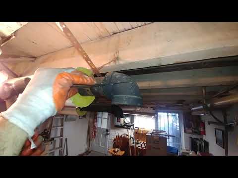

  • Gordo
    Gordo Posts: 857
    @Onepipe : I hope this may be helpful
    https://youtu.be/toXWEPW6ft4

    @Gordo video is spot on and is the best way.
    Pounding with hammers may cause damage in other locations.
    If you do use 2 hammers use a big hammer for a backup and a small hammer to hit with. You need to keep the backup tight against the fitting.
    I have seen idiots pound away with one hammer with the pipe bouncing and doing no good
    To add to @Gordo video, making another slice in the opposite side of the fitting lets the fitting open up and crack on the opposite side.
    The cut on the opposite side doesn't need to be very deep 3/4 of the way is enough. You just need to take the strength out of the fitting.
    When you pound the screwdriver or chisel in the crack the slit on the opposite side gives the metal "some place to go"
