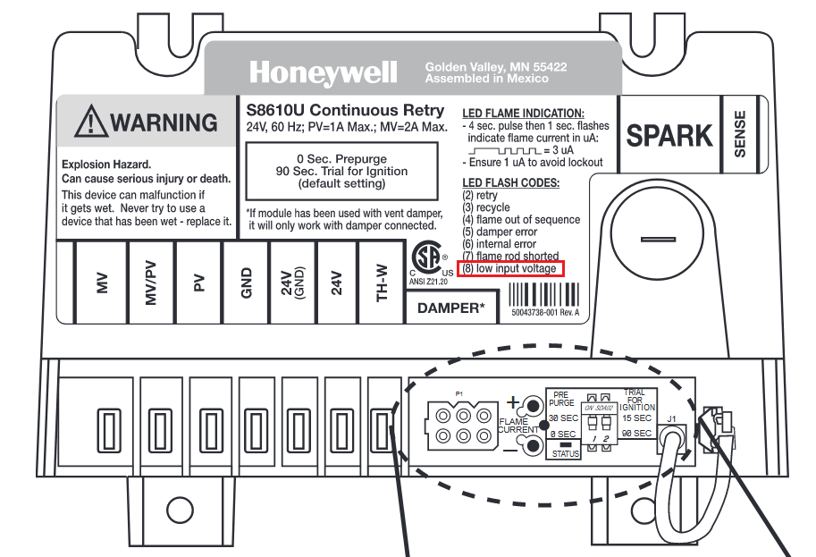

  • I have same issue I got a same controller like you I got a led blinking 8 times

    109A_5 Posts: 4,759
    Just in case @Victoralbert does not re-post.

    8 flashes indicates low input voltage. Your 24v transformer could be failing. Meter the 24v and GND terminals to see if you actually get 24vac.
    109A_5 Posts: 4,759
    Transformers usually do not fade away. If the 24 VAC is actually just low, the transformer may be over-loaded, in which case the transformer may be excessively warm. Or there is a loose connection or a defective control or limit with either the 24 VAC and/or the 120 VAC wiring. Any of which can cause excessive Voltage drop where it should not be.
