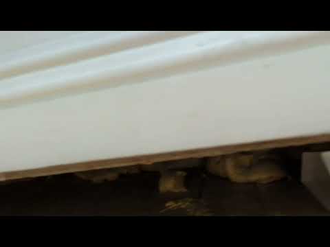

I live in a 1960 multifamily high rise apartment building. We have a low pressure vacuum steam system. Of course, the building is way out of wack, and most of the steam traps haven't been replaced since I was little... I found a "learning to read" type of card when I made them change the trap in my room.
Now here's the weird issue. The steam trap in one room is making this loud buzzing noise! I made them change it, so it's a functional trap. It's coming directly from the trap too, I've checked with a mechanics stethoscope.
Listen here, since I can't upload an audio clip to the forum:
I do. Lots of people don't. I wonder if the pressure is so high that it's causing this. Last time I was in the boiler room I saw it near 2 psi... Would that cause a steam trap to scream if it's designed for low pressure steam vacuum?0
It sounds more like a Vacuum sucking than Pressure leaking.... Just because the unit is hot doesn't mean there's steam still filling it... It could be something in the trap seat blocking the surfaces from smoothly mating... vacuum is my bet..if it's still buzzing..One way to get familiar something you know nothing about is to ask a really smart person a really stupid question1
Sounds like vacuum to me as well, however I did once install a steam trap that groaned like something out of a horror movie.0
What if you close down the valve on the emitter to slow the steam down? There is probably a mostly closed setting where you get enough heat and less velocity.0
Well, y'all will get a kick out of this. They're running a mobile boiler while replacing the actual boiler. Tonight this radiator reached 255°F.
...this is like, 15psi, right?
I'm actually amazed they're getting it that high. I will CACKLE at the board if the new boiler ends up blowing steam out of the pressure relief.1
