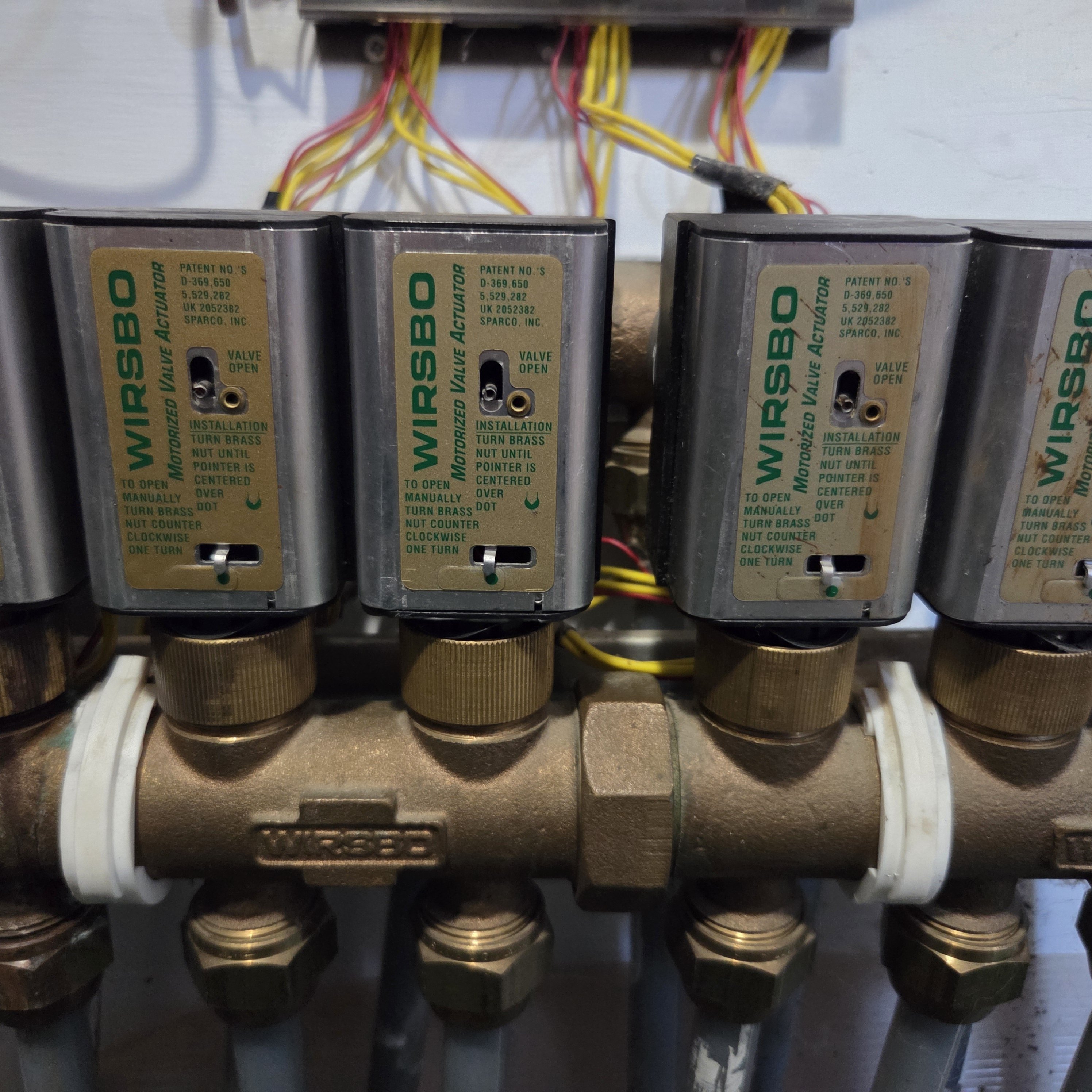

These pin valves are indexed for flow. Is there a tool for adjusting this?
    hot_rod Posts: 28,705
    A piece of flat stock with a tab bent down and a hole drilled into it?
  • I tried to move it with a screwdriver, but it just stripped. Thirty years old - I think they’re frozen.

    This house has 4 zones and the owner who is an engineer installed a bank of switches in the main hallway to control the individual rooms within each zone. Each switch turns off 1-2 loops depending on the size of the room.
    PC7060
    Quite the wiring "nest":)
    Indicator lights also?
    Did you find a work around for those old PowerTrack actuators?
    edited March 2023
    No lights. The new Uponor actuators will fit on the old manifolds if you use the specified adapter ring.
    I think the owners will have me replace the manifolds because of the stuck pin valves. Either the loops don’t heat or they overheat.

    Alan, the black caps on the unused valves is the adjuster for the flow control. Take the cap off and turn it upside down to use it. I will also use a pair of needle nose pliers when I can't find the black cap. I also spray WD-40 of the pins and manually force them up and down a few times to make sure they are loose.
    Those valves should also have the indicator pin centered over the green dot when they are powered down. You loosen or tighten the mounting ring to adjust them.

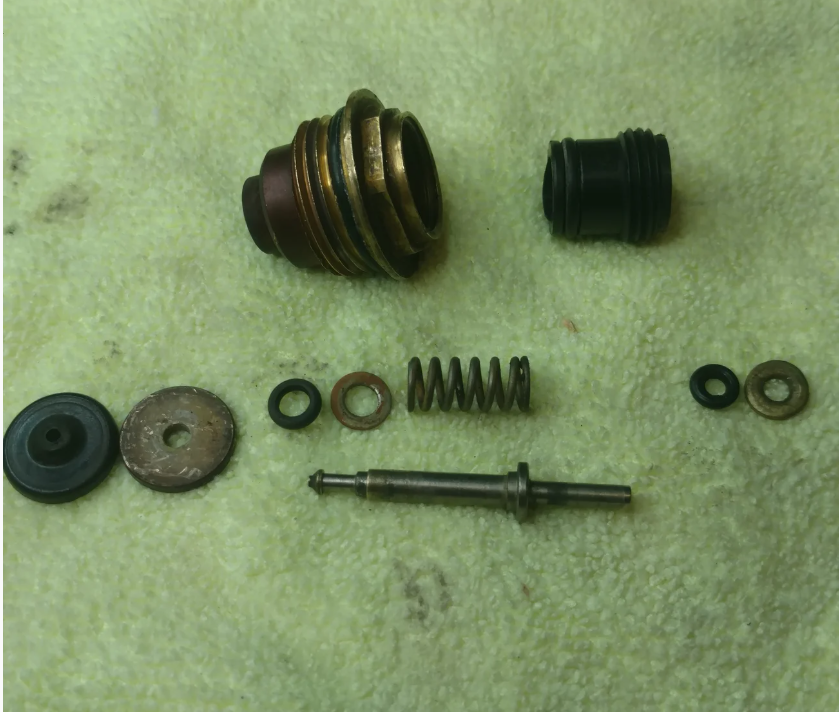

    Those black adjustable tops on the manifold cartridges. I can’t seem to get a straight answer on how they actually work. When you remove them, they don’t appear to interact with anything inside. When you tighten them down, they seem to either preload the spring in the cartridge or limit the stroke of the pin… or maybe the stroke is limited because it’s preloaded—hard to say!
    I guess what I’m asking is: do these disks adjust how far the valve opens when the actuator pushes on the pin to fine-tune flow, or they an option to force the valve some amount to allow a constant trickle of water through the loop? I’ve become more curious because I’m seeing some flow rate issues that seem to be causing my boiler to short cycle. While investigating, I noticed that once the actuators open, they become looser and more wiggly—odd, since you’d expect them to be under more tension. My gut says they’re not properly pushing the pin down and are instead pushing themselves away. The pins aren't stuck and move freely (albeit the springs are strong) Have you come across this before?

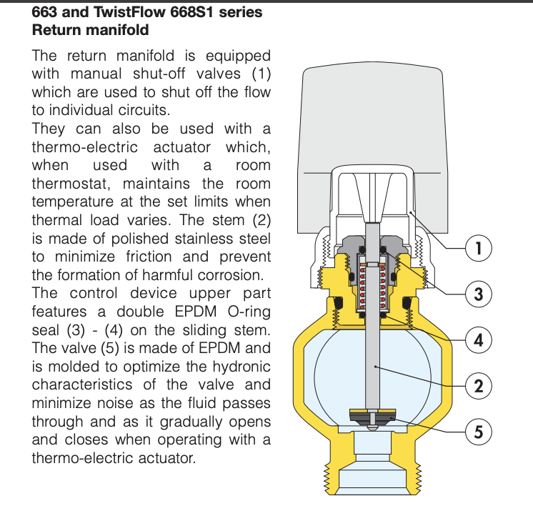

    The plastic caps (#1) act as shut-off and flow adjusters. With the cap removed the port is wide open.
    Most of those caps have two threads. One threads, the larger one, attaches the assembly onto the manifold. The inner thread allows the cap to move up and down to either regulate, or screwed tightly down it turns that port off. The white cap (#1) in this attachment.
    A cut-away shows the pin and shut off operation. This is a Caleffi, most all brands function this way.
    The height of that pin is what determines which actuators will work properly. Most are the same manifold attachment thread but the pin (#2) height and pin stroke varies from brand to brand.
    There are after-market adapter rings available. In Europe I have seen kits with numerous adapters to interchange actuator brands. We made brass manifolds for Rehau for years, it required an adaptor ring to use their actuators.
    A mismatched actuator will usually screw on, but if the stroke is incorrect the valve may always be open a small amount, or not open fully, due to the wrong stroke length.
    When you remove a cap and screw an actuator on, it closes the port, as the thermal motor warms the pin (#5) rises up. It lifts the washer #5 off the seat.

  • This is what's inside my cartridges (not my photo but exactly the same). The black cap is actually a cylinder that seals against the outer wall and the top of the pin sticks out through the middle. I'm fairly sure it only pushes down on the shelf of the pin and pre loads the spring/adjusts the starting elevation of the pin. The actuators are tightened so the indicators are on the green dots (or near because I'm playing with them) and they are nice and snug. The moment they turn on; the indicators move all the way to the left and they are loose and easily wobbled. Using a laser thermometer on the outgoing loops, I can tell that there is terrible or no flow (temperature is much lower than the outgoing manifold. If I tighten them down until they move water (temperature of the outgoing loop = to the manifold). I do this by turning a little bit at a time and checking the temp and/or pushing down on the whole actuator to see how much space the valve has before bottoming out. When the thermostat is turned back down, the indicators can't return to the green dot and they are way snugger than they were before. At first I thought that maybe they are still retracting and everything is just out of calibration….but when I loosen the brass ring again, I can hear the gears moving so the actuator isn't fully retracted until I loosen the ring. So the big question seems to be: why is it that when they are actuated they lift themselves up and don't push down the pin? The pins move freely and springs typically weaken over time - P.S. Thanks again for listening to me rant and giving advice. It's truly appreciated.
