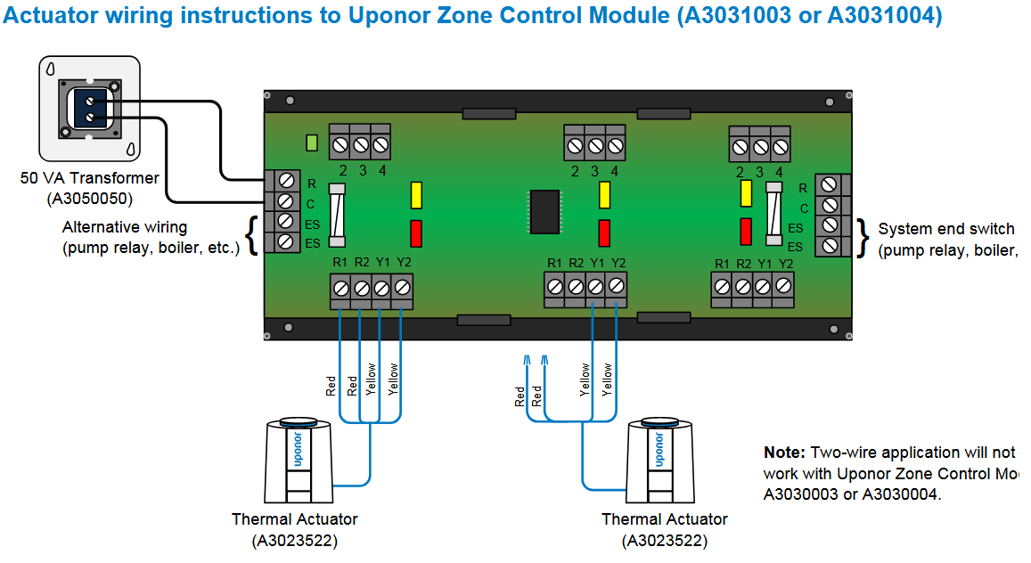

In a new install, why would I pick a 4 wire over a 2 wire thermal sealed actuator? What would determine this?
    hot_rod Posts: 28,704
    4 wire means it has an end switch to trigger the boiler or a pump. If you have multiple thermostats you probably want 4 wire.
  • chippy2
    chippy2 Posts: 44
    wouldn’t the controller manage turning on the pumps and boiler?
    109A_5 Posts: 4,759
    The End Switch verifies the actuators did what they were commanded to do before the pumps are turned on. Your controller part number ?
  • Kaos
    Kaos Posts: 1,003
    With modcons and AWHP where you are running constant circulation, you can use 2 wire actuators. There you don't need anything to trigger the boiler as it is always running.
  • AlaskaDick
    AlaskaDick Posts: 54
    As has been described in other posts, a delta P circulator is well suited for use with the 2 wire actuators. Flow in the system will be continuous, but the volume will vary with demand. A modcon boiler can be configured so that it cycles on and off and varies its output to match the load as the actuators open and close and the heating load varies.
