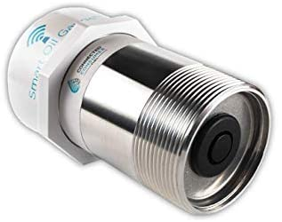

  • SlamDunk
    SlamDunk Member Posts: 1,820
    To anyone else who may be concerned about their oil consumption, I had my doubts about this smart tank indicator's value but after watching one in action this year, I changed my mind.
    it is pretty handy. It will text you when you reach a predetermined level so you can call for oil (think of non ambulatory people or if you are providing eldercare) and when you received an oil delivery,
    It will tell you how many days of oil you have left and dices your gallons per hour by hour, day, week, season. And you get this info live rather than sticking tank or waiting for the oil bill.
    It eliminates a lot of guess work and if you do something like replace your windows or add insulation, you will be able to see if it made a difference

  • SlamDunk
    edited January 2023
    The reason the owner of this system I am familiar wiith, purchased this smart tank indicator was because his float guage indicated more than a quarter tank but when he filled it, he was near empty.
    Still, if you are physically unable to get into basement, this is helpful. If you are looking after properties from a distance, this tool can be a time saver and it is a troubleshooting tool.
    If the OP had one, he/she would have a clear record of before and after service performance and can do something before the heating unit sooted up or after spending an extra couple hundred dollars in fuel because the burner was not properly tuned. The tech could have tuned burner with a larger nozzle. How would a lay person know?
    As you can see from responses: "how can you tell? And , youre just guessing, looking to blame someone without any real data"" is also likely to be what OP's service company will say.
    But if the OP was able to post graphs that showed, for example a 25% increase in consumption with relatively stable weather, we could have said, they made a mistake. Call them back. Get a second opinion. Or, that is normal.
    It is a handy tool for anyone who could use it. It provides data to homeowners. Maybe this should go to Dan Holohan's other tread, " Do you prefer your customers to be educated?

  • SlamDunk
    edited February 2023
    I just wanted to add this for other homeowners who may want more precision than a mechanical tank float to monitor oil consumption.  Wow, the photo came out bigger than expected!
  • SlamDunk
    scroll way up to find link and literature.  I would like to believe some programmed math would compensate for curves.

  • Waher
    Waher Member Posts: 373
    My oil service company uses an ultrasonic tank monitor called a Gremlin to track levels for deliveries (dials home once per day with AT&T cellular service on their dime) and it allows me to monitor how much fuel is used on a daily basis with a month long log available for viewing. When compared to the thermostat heat call run-time logs and the GPH of the nozzle on the burner, I can determine how much oil went to generating heat vs. hot water generation.
  • SlamDunk
    @ron,
    Thread count may not matter. This from your link's FAQ:
    I just had my tank filled, but the Smart Oil Gauge is not reading completely full, why is this?
    When a tank is filled, the oil level is often too close to the ultrasonic sensor to get a reliable reading, so the Smart Oil Gauge will just say 'Full'. There is also an airspace kept at the top of the tank to prevent over-filling. As a result, a 275 gallon tank typically holds around 250 gallons when completely full.
    I initially thought this was an expensive toy but have changed my mind. This past weekend when temps were in single digits, the burn rate was 4gal/day. If you see 4gal/day when outside temp is 40, you know you have a problem. I see more benefits than drawbacks.
  • gmcinnes
    gmcinnes Member Posts: 130
    @ron I looked at some questions on Amazon and it seems they use a fixed geometry for common sized tanks and calculate based on that.  Guess you're SOL if you're keeping your diesel in a cattle tote  :D
  • Dave Carpentier
    Dave Carpentier Member Posts: 640
    Its too bad they dont let you trim the max/min. Seems simple to implement, but perhaps could cause support calls when people bugger the procedure up, so they thought.. keep it simple.
