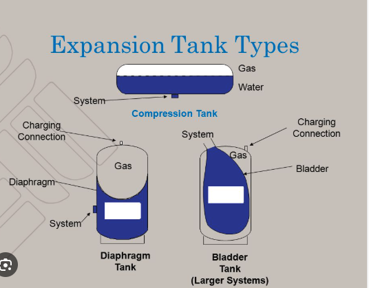

    If you you have a good estimate of the system volume you can use a Critical Sizing method. 3 simple steps.
    Or error on the safe side and oversize the tank.
    Bladder or "bag" type expansion tanks will have a larger acceptance, close to the tank size actually. A more expensive option.
    Here are the 3 common expansion vessels.
