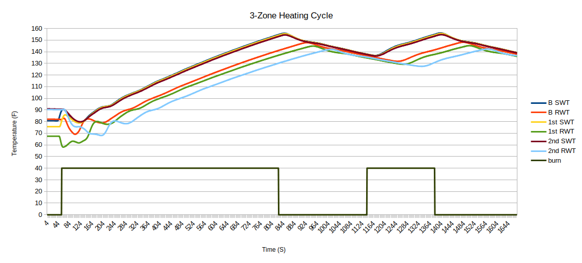

  • fentonc
    fentonc Posts: 343
    I made this graph with my "boilertron" setup. It uses a microcontroller with 6 temperature sensors, and then light sensors to monitor the 'burn' and 'circulate' indicator lights on my boiler. Lots of one-off, situation-specific design choices. It's a lot of work with pretty much zero potential profit to make an off-the-shelf version of this, but cobbling together your own isn't very difficult if you have any experience with microcontrollers and hobby electronics.
