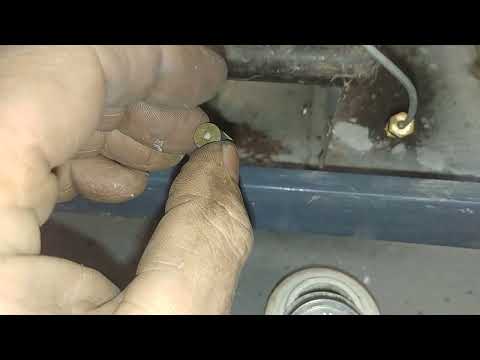

One of the 3 burners in my Gas Boiler is very low (see photos below). I was wondering if the holes or the tube may be clogged and need to be reamed out, or if it's something more serious.

    Looks like a Crane boiler. Pull the burners out they are probably plugged with soot and dust. Those are good heavy CI burners and last forever. Take it all apart and clean them. Shut the gas off. Reach in and grab the rear of the burner and lift up and twist push towards the rear of the boiler. Or call a professional

    Wire brush the top of the burners and then take a drill bit that fits the flame holes and clean each one and then shake the debris out. Be sure and clean any flame crossover holes, too.

    OK thanks, I'll try that. I've already taken all the burners out when I replaced the thermocouple a few weeks ago, so that won't be a problem for me. I'm just not sure what the flame crossover holes are that you mentioned?

    a spider built a web in the orifice. pull that burner and run a small wire or pipe cleaner through the orifice.

    Crossover holes are the holes that conducts the flame from one burner tube to another. Ya, spider webs are something I have encountered many times, especially pilot assembles. I have thought it was the odorant that is put in NG that attracts them.

    OK. Thank you all so much for all your helpful advice. So, I cleared out the hole in the orifice and, as also suggested, I reamed out all the flame holes in the burner and the larger pipe hole and, lo and behold, the first burner is working again as it should.
