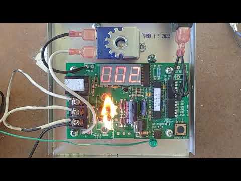

Burning Up A VXT-24 For Science
Gordo
Member Posts: 857
In the video below, we send 120 volts into a circuit designed for 24 volts.
The expected result happens.
See you on the other side...
https://youtu.be/0OCObiah0cw

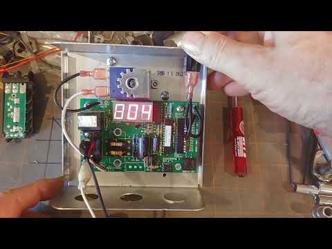

We were able to replace the resistors and get the board working again.
https://youtu.be/6XfitcnYO-4
All this goes to show that most of the circuitry of the VXT-24 can survive an over voltage
and it is unlikely that a mere power outage would damage a VXT-24 and cause it to fail.

@JUGHNE
LOL Thank you for your kind words.
I think the circuit energized the coil briefly (you can hear some buzzing when the 120 volts is first sent in), but it appears to not be on long long enough to trigger full power to the coil before the resistors burn out.
I believe I set the delay to 30 seconds to increase the likelihood of maximum damage.
