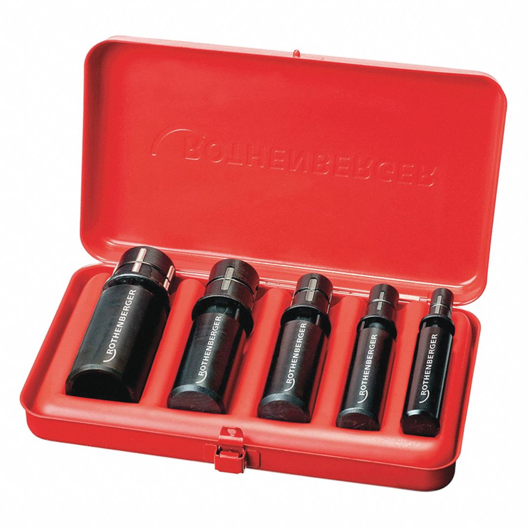

  • STEVEusaPA
    They also make nipple chucks for stationary pipe threaders.
    https://static.grainger.com/rp/s/is/image/Grainger/60PY57_AS01?hei=1072&wid=1072
    Just don’t buy them from Graingers.
