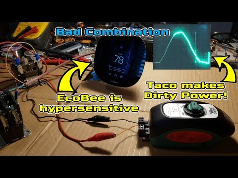

    @researcher, Please watch the video. Apparently you are not the only one with this problem of incompatible Electrical / Electronic devices causing relays to click. This video is 3 years old. I would think TACO would have a resolution by now.
    Testing issues of EcoBee thermostat used with Taco Zone Sentry Actuator
    https://youtu.be/t7SdLKTsvTM
    Curious, what type of thermostat do you have ?
    A second transformer and / or a second relay may solve the problem with the new actuator.

    @researcher, Apparently TACO uses a electrically noisy Switching method to charge the capacitors in the zone valve instead of a nice quiet linear method. This noise can have a negative effect on other electronic devices in an HVAC system.
    To isolate the noise from the rest of the system. I would try the circuit below using an additional transformer and relay. Which may be less expensive than going to a different model or brand of zone valve that uses different technology. This is one simple method using a transformer and a relay to deal with the switching noise, there are others. If you choose to use this method and you are not qualified to work on 120 Volt AC circuits get someone that is qualified to do the work.

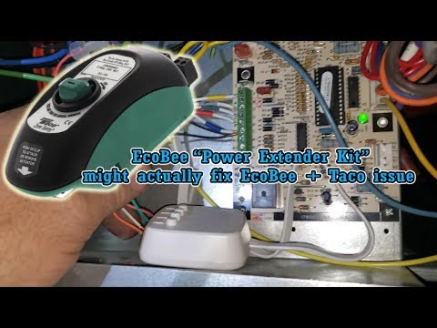

    @109A_5 in case anyone else runs into this. I also found a video where the same guy found that adding the Ecobee PEK (power extender kit) also appears to solve the problem.
    I agree that it is disappointing that neither TACO nor Ecobee is solving the root cause (without alterations, extra relays or workarounds).
    https://m.youtube.com/watch?v=EzwRLkBZcBg

    Hello @researcher, yes I did see that video too. The video's author could not explain why the PEK worked, so that method may not work in every situation.
    I asked you what type of thermostat you had and received no response to that query, so I did not know if that possible remedy would be applicable to your situation.
    The addition of the relay and transformer to your system is a more generic method that most likely provides better isolation of the TACO noise issue.
    Presently I think the Transformer and Relay solution is a more robust solution. The apparent filtering or isolation provided by the PEK may fade like the capacitors in your old actuator did.
    Without some sort of isolation or noise suppression, the noise (or more accurately stated pulses) impressed upon the power limited 24 VAC system from the charging technique used to charge the large capacitors in that version of the TACO Zone Valve apparently messes with the biasing and / or control of the Solid State output switching with at least the EcoBee, maybe others, so relay(s) in the system momentarily drop out.
    In my opinion TACO should of fixed the issue years ago. Since their Zone Valves with that technology are the only units that exhibit that issue as far as I know. Either they did not get enough complaints or the complaints did not get passed along to the correct people to correct the issue or they just don't care, I don't know.
