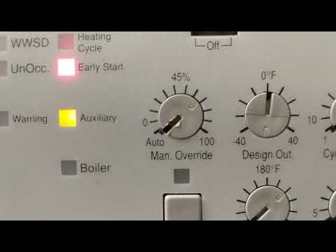

Just installed Tekmar 269, won't turn on boiler
rhodebump
Member Posts: 155
I would appreciate any ideas on how to troubleshoot my install.
Tekmar 269 installed with 1 Indoor sensor, 1 condensate return sensor, 1 outdoor sensor
Powered on, no warning light light.
Cycles lights clockwise (WWSD -> Heating Cycle -> UnOcc -> Early Start)
If I do a "Test" boiler is fired up for a couple seconds.
I disconnected all sensors (turned off all dip switches and same behavior of lights clockwise)
Outdoor temps are 50, and inside temp was 60.

try turning your Cycle Length up to 50 or so.
How old is that 269? They haven't made that control in about 15 years.Contact John "JohnNY" Cataneo, NYC Master Plumber, Lic 1784

It's pretty old! That's for sure.
thanks for your advice, I will give it a try0
