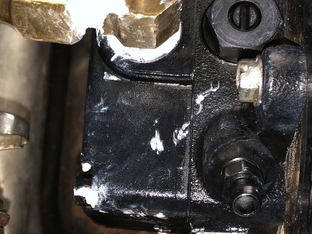

Hi guys thanks very much. The fuel lines enter the top of the tank. I am going to post some pictures. Looks to me if you look closely to the bottom of the pump the return fitting seems to be leaking. I see red fuel. When I tighten the brass fittings(I was afraid of going too tight)well I guess I need to tighten the return pipe fitting another revolution tighter. I am going to examine the coupler more closely tomorrow. I will skip the additive. Thank you.

Apparently my pictures did not work ! I will try again. Hi guys thanks very much. The fuel lines enter the top of the tank. I am going to post some pictures. Looks to me if you look closely to the bottom of the pump the return fitting seems to be leaking. I see red fuel. When I tighten the brass fittings(I was afraid of going too tight)well I guess I need to tighten the return pipe fitting another revolution tighter. I am going to examine the coupler more closely tomorrow. I will skip the additive. Thank you.

Why not just post the pictures into the thread. This way they are there for future people who come upon the thread.
You seem to be using the wrong pipe dope and you NEVER need to (or should) dope the flares themselves. You still have a leak. And you need to immediately take the firomatic valve off of the return line-against code. If (when) it fails, it will blow out your pump seal in seconds. And because it's on the return, the burner may still run for a while, pump a ridiculous amount of fuel into the chamber, and if you're lucky, doesn't ignite. If you're unlucky, massive oil spill/burn down your house.
Even without a firomatic, the same thing could happen with a clogged return line. This is why I never use a 2 pipe system and will rarely use a Tiger Poop.
But the proper answer still lies in my first post above. You need a properly trained pro.There was an error rendering this rich post.
