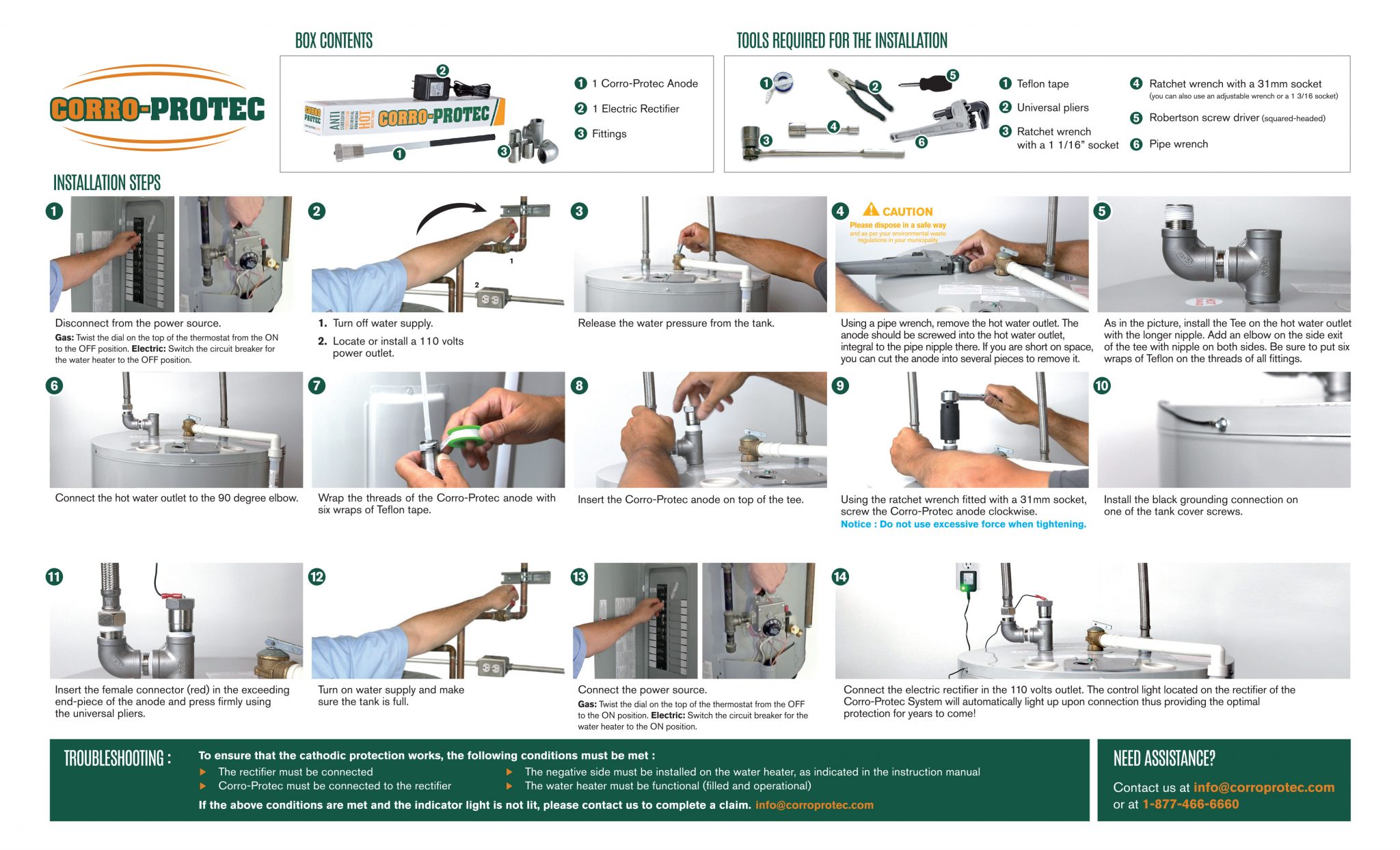

Yes, the indirect has a sacrificial anode. It's a Bosch LT160 and the anode is mounted horizontally in the cleanout access port. You can see how it is configured in figure 23 on page 22 of the manual. https://www.bosch-thermotechnology.us/us/media/country_pool/documents/download-buderus-products/buderus-manuals/6720811745_lt160-300_tank_installation_instructions_en_07.2017_us_us.pdf
I have been looking, but I can't find a powered anode that will mount in place of the sacrificial one.
One person suggested enlarging the hole for the anode and welding on a female fitting to allow the use of a traditional powered anode. It's not ideal but I think it might work.0 -
You can install it through a tee in the inlet or outlet like this:
https://www.corroprotec.com/wp-content/uploads/2020/09/corro-protec-installation-guide-for-bradford-white_EN-2048x1244.jpg1
