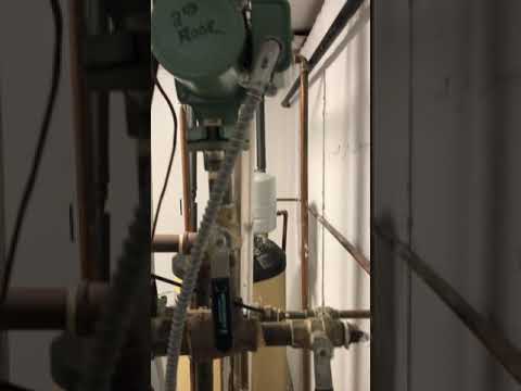

Hmm I'm not sure how to read this,
the bottom red arrow is almost at 75 psi but the bottom black needle is at like 9 psi. Also sorry but I'm not sure which valve you are speaking of, I'm a total newbie. This is a video of my boiler, would you be able to point to me which valve it is?
https://www.youtube.com/watch?v=bZltO8tDFsE&feature=youtu.be
Is it this thing on top of the expansion tank?
Sounds like air has gotten into your system. The noise you are hearing is water and air taking up space in your pipes.
Your gauge reads about nine psi . The read arrow at about seven o'clock is a set point reminder and not an issue here. I'm not so sure your gauge is reading properly. Your system from what I can tell needs a lot of service.
The air needs to be purged and if it were me, I would replace the air scoop that you have with a microbubble air separator. Something like a spirovent or equivalent.
You probably have a leak in the system somewhere. Has any work been done to the system recently?
The high vent in your last picture is probably not working either and may be one of the reasons causing your problem.1 -
