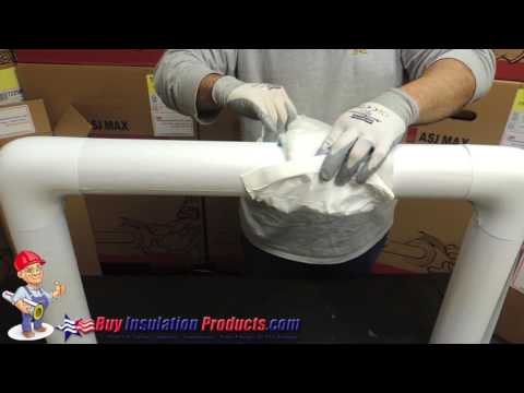

What do you think about something like this for valves? Would the Velcro be air tight enough
https://www.youtube.com/watch?v=TayZ9uJABb0 Sean Wiens0
