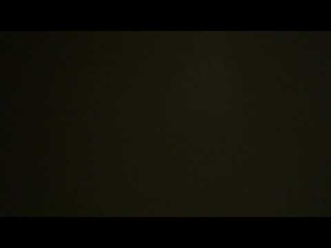

I do have one question. When we finished testing each zone twice to make sure all was working well there was this sloshing sound coming from the boiler. You can only hear it when the burner isn't running. The installation guy said it's air in the system and it should work it self out after a while. He did put on an air bleeder valve that I could hear releasing air when the system first started up. It's only been a couple days and the sound is still present. It doesn't appear to be causing any issues as the system seems to be working fine. How long should I give it for the sloshing sound to go away?

I hear the sloshing sound when the burner isn't firing but the zone(s) are circulating.

Thanks for your reply. The installer did mention the boiler was pitched. I actually created a video with my phone right next to the boiler to record the noise. My daughter showed me how to upload it to YouTube so here it is:
https://youtu.be/Gk9rfxFixG8 0 -

Hello, I just had a System 2000 installed in November 2020. I love it! (I am an engineer and everything about the design appeals to me).
I hear the same noise coming from the boiler (the noise in your recording).
The contractor did a superb job and I am very pleased with installation and the service. In addition, when I reported the water noise, the contractor responded promptly and came to my house with a K.E. representative to check out the water sound. The Rep. was very responsive and suggested replacing the circulator pump (on the boiler) with a Grundfos Alpha2. My contactor installed the pump (and by my request) installed a Calleffi 551 air separator in the return line of the heating zone. I cannot overstate the excellent customer service I have received.
In spite of all our efforts, the water noise is still occurring. I would like to share some observations (for possible clues to the problem);
1) In the purge mode, If I close the valve to the plate heat exchanger, temporarily, the noise stops.
2) In the purge mode If I set the the Alpha2 to constant speed 1 (lowest speed), temporarily, the noise stops. 3)When it is very cold outside (0 - 10 F) and, the boiler is running very frequently, the noise stops.
As an engineer I have some ideas (hypotheses) about what may be causing this, based on my "black box" observations, however, I would love to hear about someone else's experience and (hopefully) success in solving this problem.
Question: Did you find the problem?? Also, would like to hear from anyone with experience with this problem.
Thanks, Carl
