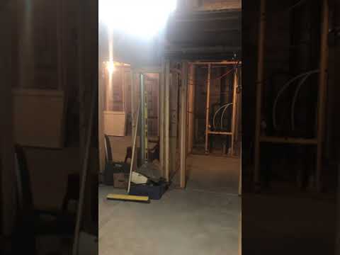

The old boiler in this house was covered in asbestos, as well as all of the steam piping.
The basement floor was all dirt and gravel. The owner decided to tear all of the piping out so he can remodel the basement. Along the way all of the radiator pipes were cut flush with the bottom of the floor joists.
..So I finally get to play "DeadMen", for real.
I decided to run two counter-flow mains, the radiation on both the north side and south side are almost identical.
We cracked all of the nipples going into the first floor radiators out of their prospective valves. second floor radiators were subject to the megapress gun. This one was particularly tough to get, the megapress jaws are huge!
Went with two risers even though the boiler was only an IN4, into a 3inch drop header. Man, I love this stuff.
I attached a video I took so I could remember my thoughts in between that job and other jobs.
I think I nailed it. but if you guys have any pointers, that is why i am here on this forum, to learn.

    My only pearl of wisdom is, since you have a short boiler and a lot of headroom above it, you should still make the risers as long as you can, because it prevents carryover from getting up into the header.

    Just to illustrate, here are two possible ways to pipe a drop header using roughly the same amount of pipe:
    The second example is the way to go, and it only requires a little more equalizer pipe.

    4 feet is great. I don't think water droplets can go any higher than two feet, but I can't remember where I got that number. I always figure more is better, and it gets the header up out of the way.

    Yup. Here's how I did mine for comparison.
    I put the unions at the bottom of the risers and included king valves on the takeoffs, but same school of thought.

    Looks beautiful. Just curious, since you put in all of the mains where did you decide to locate the main vents ? How did you determine how many you needed and what brand? Seems like you could use the Big Mouths with the really dry steam you will probably get.

    @jhrost there are tees x 3/4 there for main vents. That was day 3 of the job where I got the pipes all in to the boiler room. Day 1 was all measuring/planning and gathering materials and equipment.

    He’s going to the finish the ceiling and leave an access panel. So big mouth are out of the equation. I can’t be that guy who gets a bad big mouth.
    The rule of thumb here has been for every 20’ of 2” pipe you use one big mouth or two #2s... IIRC
