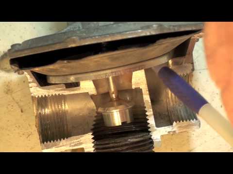

I'm trying to assist a friend of mine to troubleshoot his gas train.
He has a Maxitrol RV53 and a Honeywell V88A, they are hooked up to Baso L62AA-5 Safetys.
  • The pilot is lit.
  • All the flutes have a small blue flame upon call for heat. The emphasis on SMALL.
  • I have opened the Maixtrol cap and tightened down on the "PLATED" spring, --- no change.
  • I have checked the voltage at the solenoid on the V88A .. 24VAC
  • I have removed the bleed valve tubing on the V88A .. --- no change
  • The solenoid is very WARM to the touch
  • I do hear the audible click of the solenoid at call for heat.
  • I have NOT put a manometer on the line.
We are going to 1st attempt to replace the solenoid as that seems to be least invasive.
Last season, this was a roaring beast, now, a small simmer.

    JUGHNE Member Posts: 11,568
    Sounds like low gas pressure. Is this LP or NG?
    Should check pressure on both sides of the regulator. IMO
    Until the gas pressure can be measured on the inlet and outlet of the boiler gas regulator, you are just guessing.
    If the pilot light looks good then you might have good pressure to the boiler.
    IIWM, I would defer to someone who can measure pressures.

  • jpf321
    jpf321 Member Posts: 1,568
    edited October 2019
    i updated pics in the album linked above .. i include 1 of the pictures in this post to show where I measured the pressure from (the pilot valve) .. i'm not sure if that silver thing is also a regulator, if that's a poor choice of places to draw a reading from, I'll find another port ....
    using a water tube at that location, i measured 7"WC ..
    there are no markings on this old Bryant Boiler that spec the min inlet pressure. maybe it's in Dan's Beacon Boiler Ref -- no, the spec is not there.
    the iTRON regulator serial number plate in the meter room shows "6 IWC" as it's out pressure with a "LT GRN" Main Spring.
    there is a metal tag stamped on the street inlet before the 1st main valve which states SYSTEM PRESSURE 15 PSIG with EFV, and there is an EFV installed.
    at this point, you may tell me to measure the pressure at the maxitrol .. that will involve taking apart quite a few pipes.

    If you look at the spec sheet you posted here for the gas valve,
    There is a square head 1/8" plug for pilot connection.
    That would be the incoming pressure to the gas valve after your pressure regulator.
    The pilot is not connected there in this case because it is better on its own regulator and also one usually wants to operate the manual gas valve for testing/troubleshooting procedures.

    What does that 1/4" tubing that goes between the regulator and the valve and goes somewhere to the burner do? (I am in no way making suggestions, I am just curious how it works myself since the pilot is fed from tubing from a regulator before the main manual valve).
    You do need to check the incoming pressure while it is firing, if that is dropping under flow because the new distribution is not right then it will underfire.

    @Juhgne -- I did see that square port, i didn't think to measure there, my bad. From the language which you use above, that "gizmo" is some sort of pilot regulator .. so a reading there may be inaccurate it seems.
    @mattmia2 -- there's an excellent, somewhat verbose, video on the operation of a gas regulator and explains the vent ports and why they exist. https://www.youtube.com/watch?v=n4DDnoMAHY8 -- in fact this guy's got videos on how nearly everything works. .. The vent port on the main-valve is described in the manual for the V88A .. it's really interesting how that one works. Linked above and here: https://s3.amazonaws.com/s3.supplyhouse.com/product_files/V48A,F,J,V88A,J-User6.pdf
    @ALL -- the Lic. Pro is coming in tomorrow. I've been promised to be kept in the loop..
    my guess is that some grit/dirt/etc lodged in the gas chain regulator especially due to the meter room piping work performed over the summer .. why it didn't end up in the dirt leg, or the NG dryer or the DHW, i won't have an answer.
    maybe it was grit introduced by shutting the boiler manual valve which was shut during the piping work and inspection. maybe that's why it only went to the boiler equipment and not the other appliances... again why didn't it end up in the dirt leg of the boiler .. dunno.
