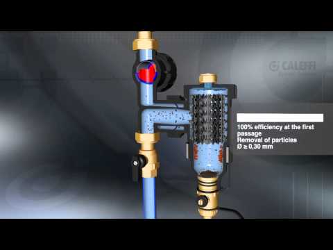

    hot_rod Member Posts: 27,856
    We have done a lot of testing and development of the Caleffi products, and also tested competitors.
    We started with dirt separation function down to 5 micron, and then engineered mag function for the microscopic magnetite removal. Here are some videos to watch.
    https://www.youtube.com/watch?v=CmjIi1u2HTQ
    https://www.youtube.com/watch?v=hpOhbX7Ynu4

    @hot_rod great videos. I assume both units have an air vent for bleeding.
    The DirtMag Plus is not available yet in the US, yet.
    Boiler manufacturers should consider it as an OEM component :) Might save them some warranty issues.
    Depending on pipe size we have a good selection of DirtMags available in brass, steel and composite.
    This is the most common for 1" and up pipe size.
    The upper port could be used for a gauge, sensor, air vent, a convince port for your use.
