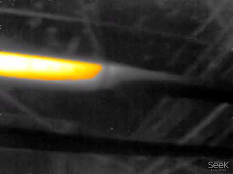

My Gorton no2s(and some no1s) are here. But before I put them on, I wanted to collect some data. And what better tool to se inside the pipes than a thermal camera. Here’s a short video I took - you can almost feel that steam struggling hard to push all that air via the radiator vents
https://youtu.be/taRBoh5Ql-U

While your at it........ insulate your mains
Excellent and informative video, which should be seen by anyone with bad main vents!—NBC0
