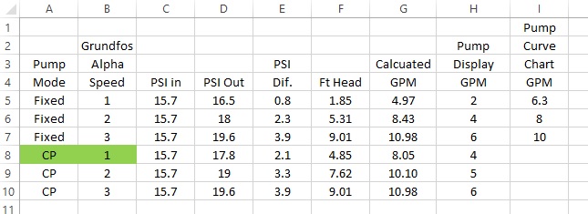

Also regarding the GPM number, has anyone compared it with an actual flow meter?0 -
I have using differential pressure... at all speeds the Alpha under-reported GPM. FWIW- the pump curve chart was fairly accurate though.sunlight33 said:Also regarding the GPM number, has anyone compared it with an actual flow meter?
Yes the auto adapt has to readapt after power failure.
The gpm readout is not accurate.0 -
I disagree with it has to readapt after a power failure. Grundfos says if you kill power or change modes, and then return to AutoAdapt it will basically pick up where it left off. Whatever learned parameters it has are stored in non-volatile memory.Gordy said:Yes the auto adapt has to readapt after power failure.
I suspect the pressure or lack of check valve might affect the GPM readout. I have a hard time believing mine is under reporting GPM, based on my temp delta and boiler runtime I would guess it's over estimating significantly (I have a check valve installed in the pump). If the GPM was accurate my boiler would have to run a lot more to make up the BTU's. My system typically runs between 2-4gpm as indicated on the Alpha, but I often have a 30-50degF delta across my supply and return (panel rads with TRVs). My return stays pretty close to 100degF no matter how hot my supply gets it seems. My 100kbtu (input) boiler rarely runs more than 15-20% max duty cycle to maintain temps.0 -
Depends on how long the power is out. Unless they changed something. He has the alpha 1 no? which doesn’t have autoadapt.
I believe the memory is good as long as there is constant power.0
