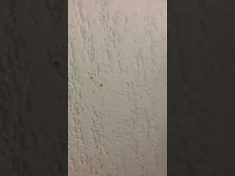

got a call about a leak in a wall on the 12th floor of a 15 story building, i was already worried because the day before i had to drain 7 floors to fix a leaking heating pipe.
got to the unit and was told by the resident that she went to hang a photo and she started hearing a loud hissing sound..

the wall was about 2.5 inches of plaster so i had some fun doing an archealogical dig to get some pipe exposed to work on it.

so I am assuming an air leak? how long was it buried?0
@EBEBRATT-Ed
Yeah she hit the 3/16 copper line with a small nail. Not sure how long it was in there but it definitely scared her!0 -
her landlord will be thrilled, she should get the bill, I almost guarantee there is something in the lease that says no holes in our walls0
I bet there was more than one person who had full throttle heat!Serving Northern Maine HVAC & Controls. I burn wood, it smells good!0
It looks like that line was imbedded in the plaster, not inside a stud space.
It would seem like it would have been installed within the space and a longer nail would have been needed to hit it.
