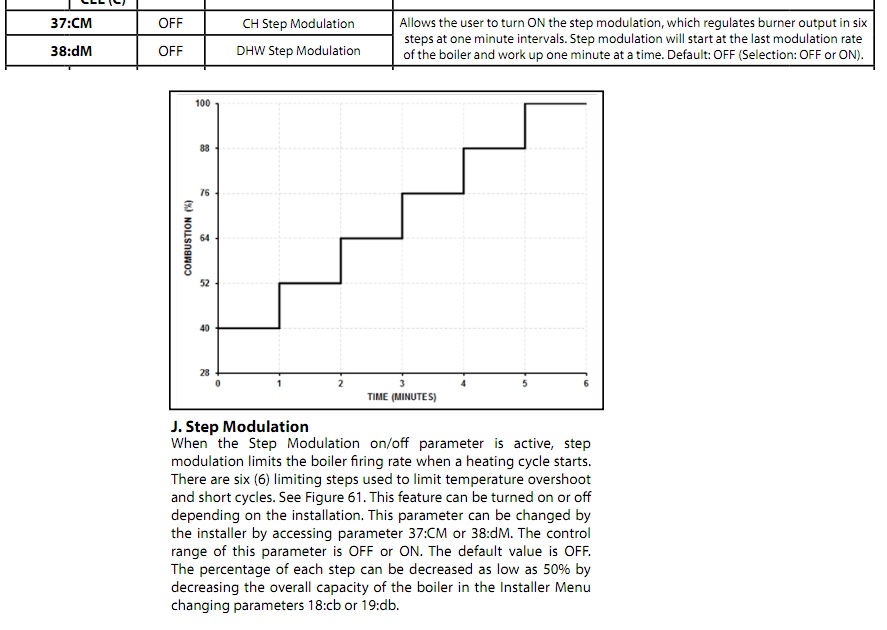

    Do you know if the UFT has any ramping functions to limit the fire rate initially (like Lochinvar)? I'd like it to hold at min fire for a while after start even if it is way off set point.
    Yes, it has "step modulation" function for both spaceheating and DHW...

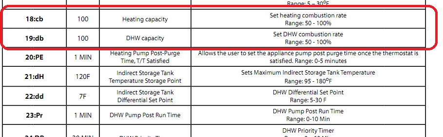

    ... it also has a "Heating Capacity" function where you can limit the max output by up to 50% of max.
    So if you have a small 35K BTU heatloss, set combustion limit to 50% (40K BTU's) and it will take longer to get up to setpoint too.
    You can use "Step Modulation" and "Heating Capacity" together to get longer burn times and slower ramp up's to setpoint.
    For a "low end" , budget minded boiler it has a ton of features... take a look at the install manual, etc...
