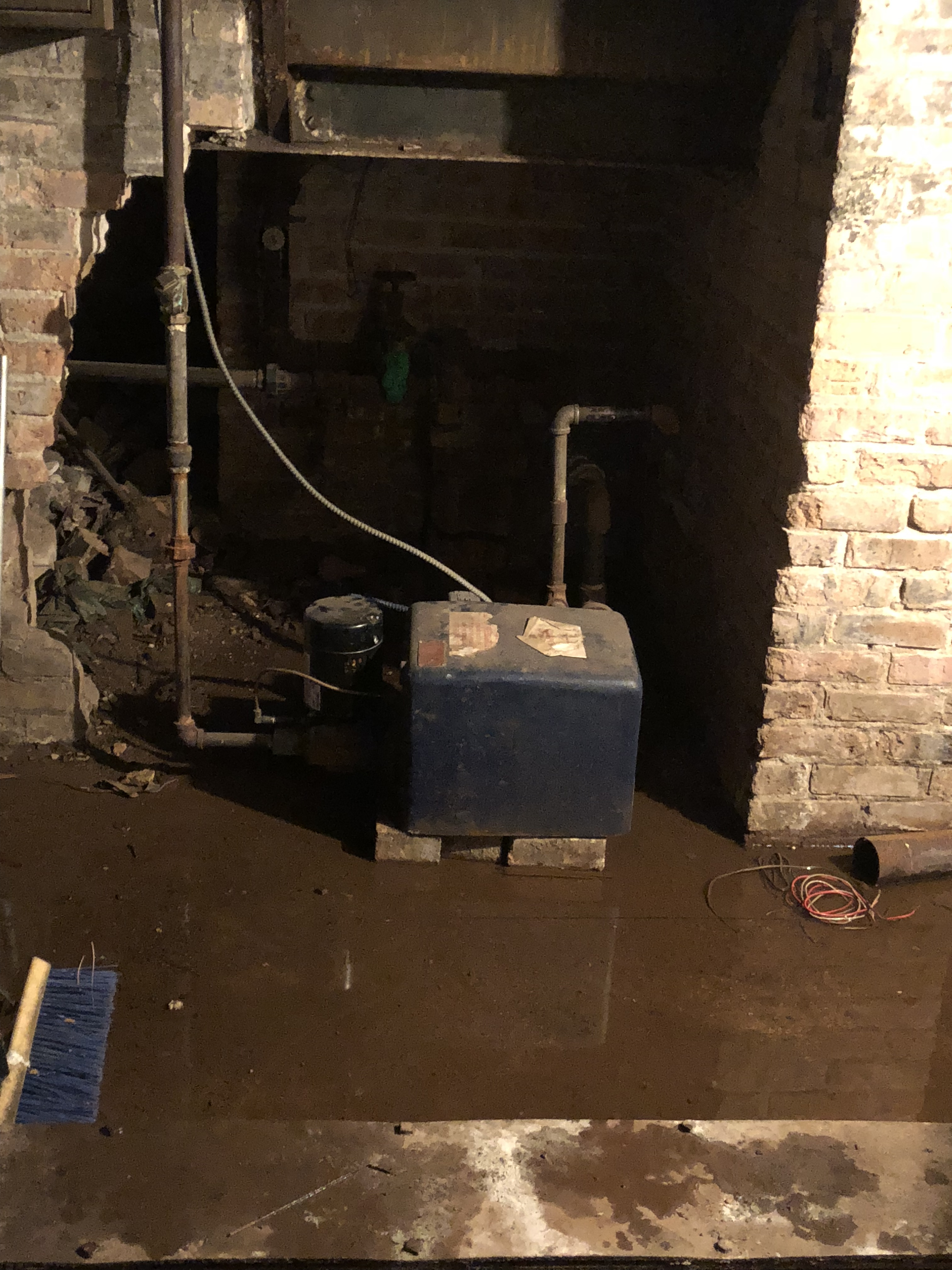

Seeing you don't need gravity to get the condensate back (vac pump) I would think zoning would work ok. Yes I would be sure the valves are sized correctly (don't line size) and have slow actuators.
Should have swing joints but I have seen plenty without them. probably a lost cause

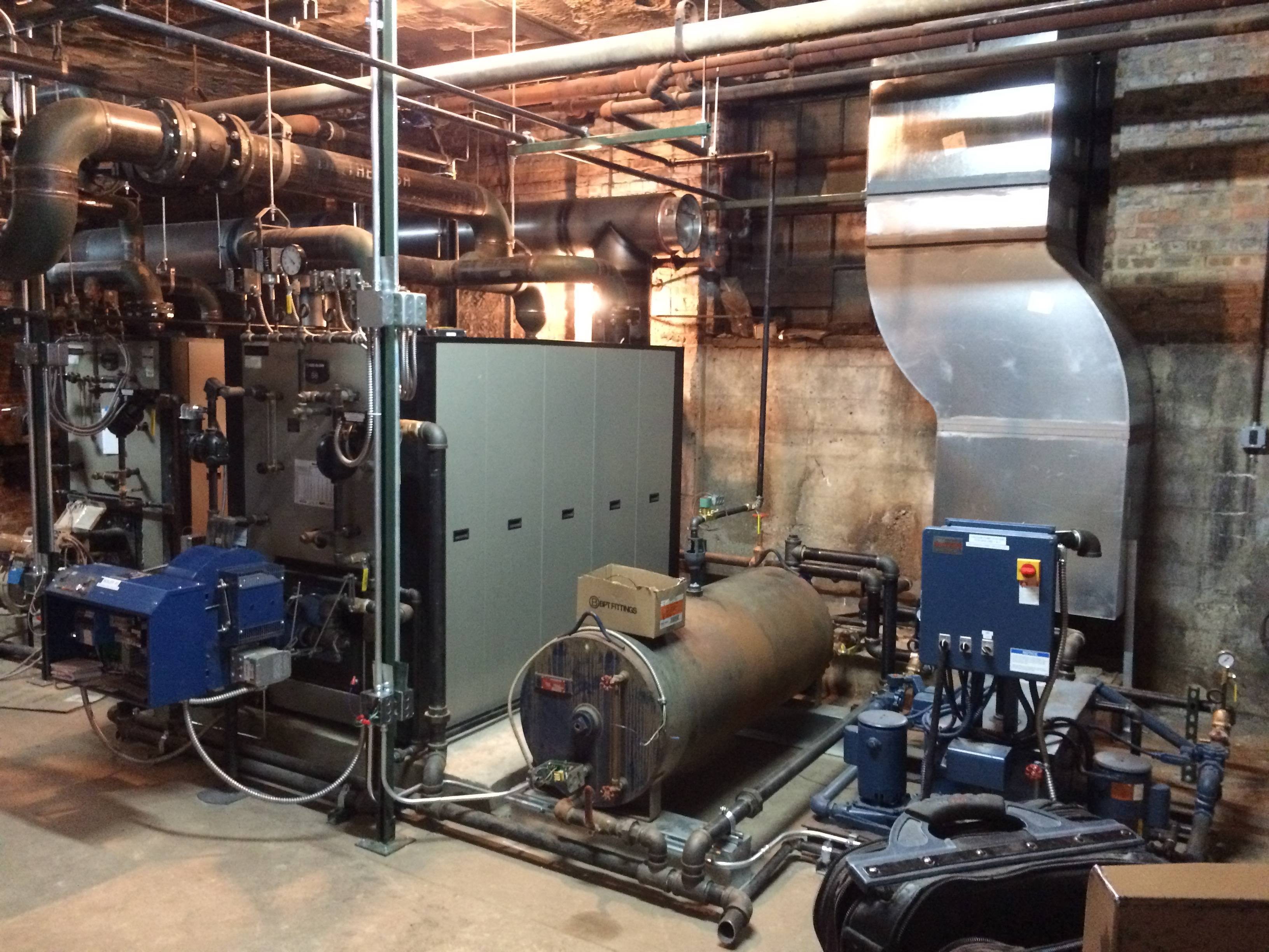

Here are some pics:
Here's the little pump down in the "old" boiler room:

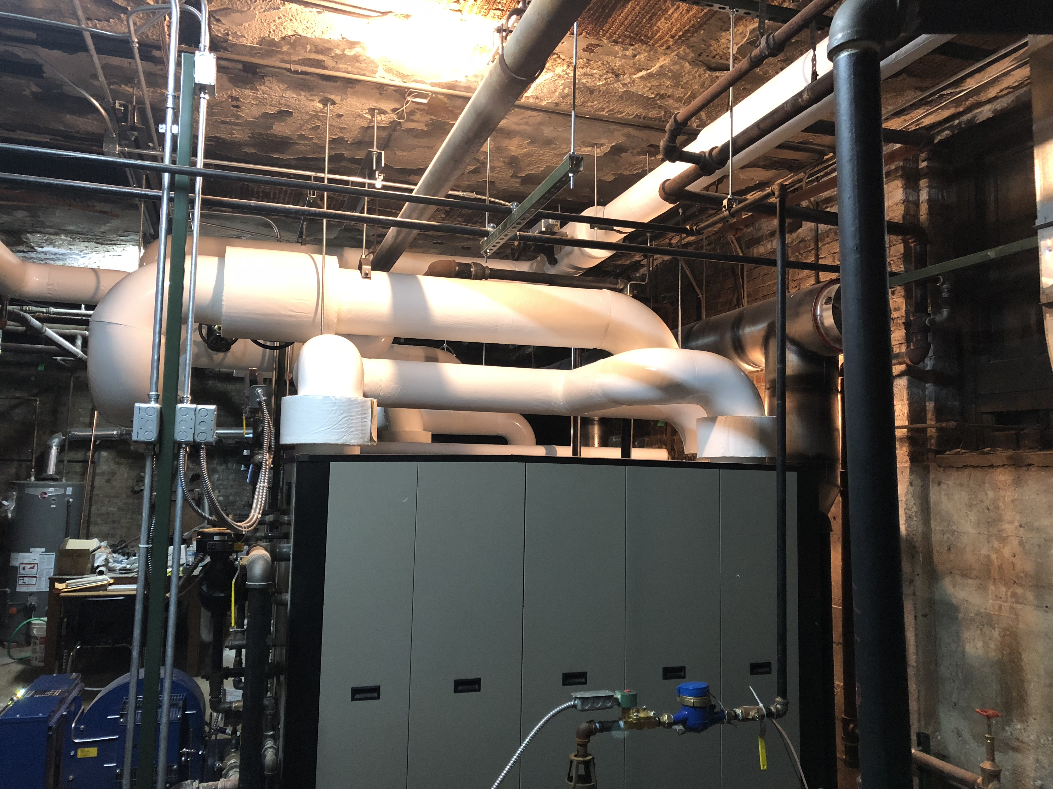

And here is the weird sidewise elbow takeoff:

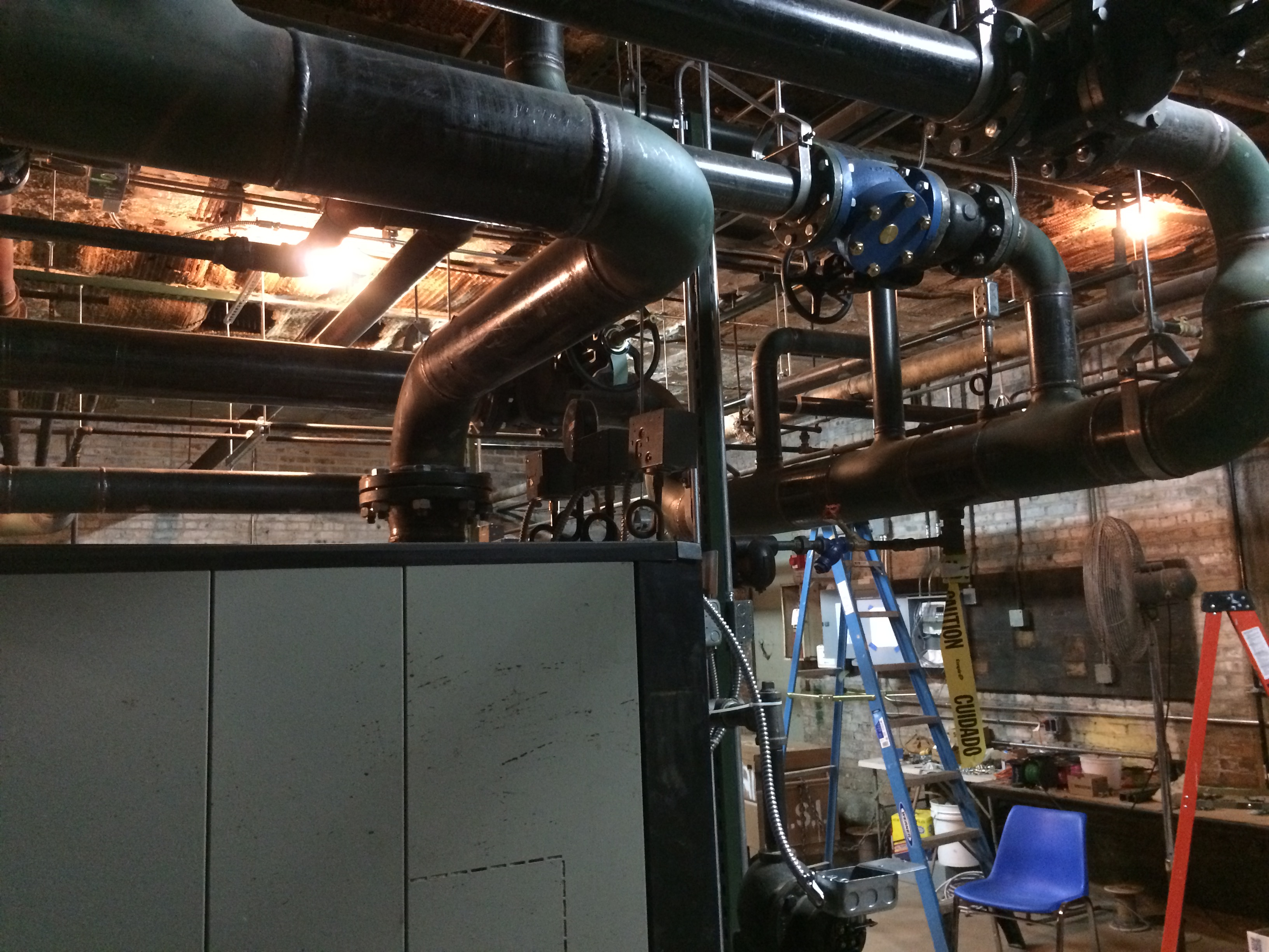

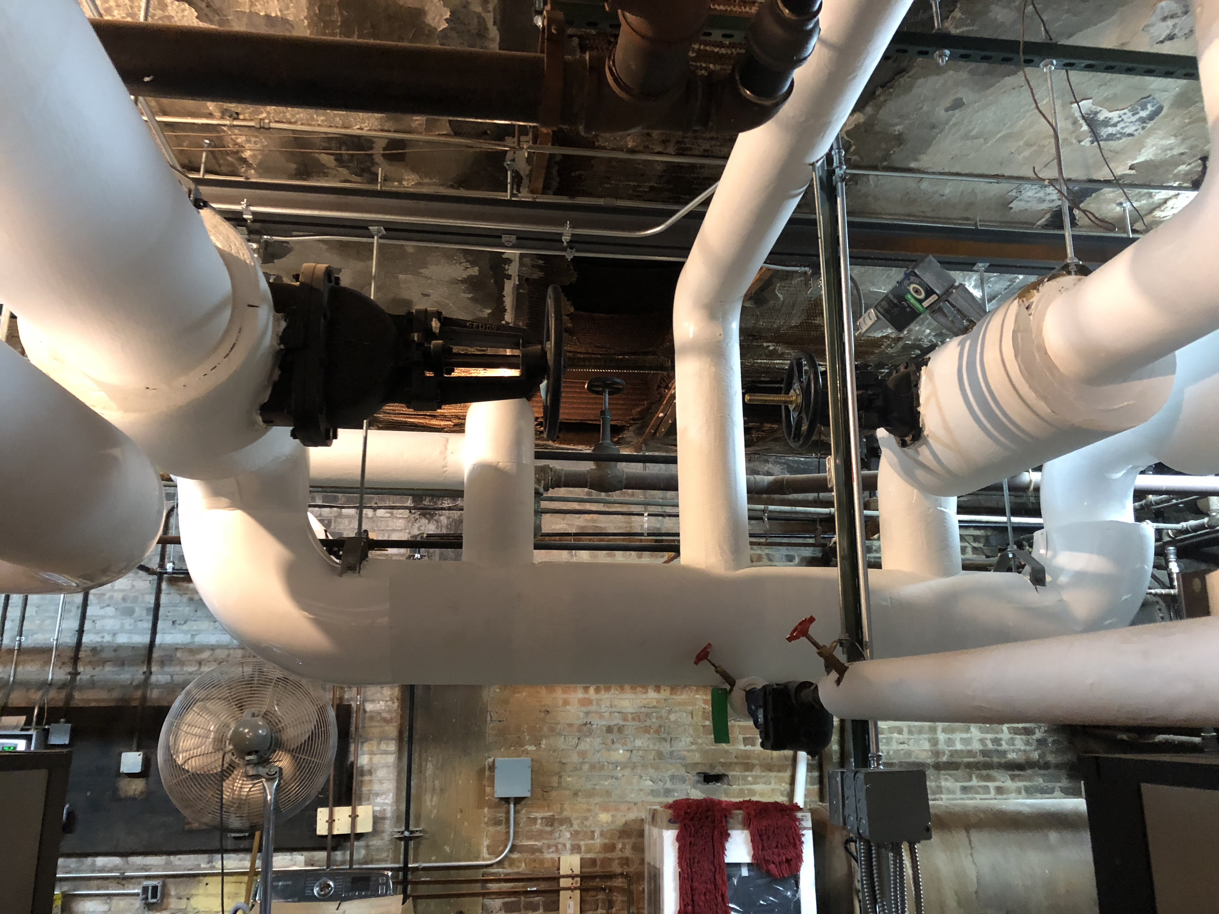

They welded the header. And it doesn't look like the risers to the header are tall enough.

@Steamhead always learning and had quick question. The main risers look really short. I don’t see an equalizer coming off the header. It looks like you’d get a lot of wet steam, and a lot of boiler water getting pushed straight up into the header and out into the system. are systems this large usually piped without a equalizer coming off the header? Maybe some other way to return the wet steam that I’ve never seen?0
@Oldschoolboiler "The new common header was piped according to the project engineer's hand-drawn diagram and not according to the boiler install manual"
Was it formalized in crayola crayon on construction paper? Would have made it easier for the other people involved0 -
When there's a pumped return, a equalizer piped off the header, is not really doing the job it does in a gravity return. It acts more as s drip. And it does look like it's there.
The risers had plenty of room to be taller. The boilers should of had their own drop headers and then dropped into a common drop header, with a drip back to the condensate receiver tank and the supplies to the system.

I wasn't able to digest your whole post, but from what I've gleaned, a big problem here is induced vacuum due to steam condensing in the headers.
You really do need equalizer lines. @AMservices post describes perfectly the reason why. And if you have steam zone valves, there should be an equalizer line just downstream of each zone valve.
The attached file shows the piping arrangement. You can use either a dropped check valve or thermostatic radiator trap in the cooling leg. The purpose for dropping the check valve is to trap some water and provide a water sealed check valve seat.
With a separate boiler feed pump set that is vented to atmosphere, there should be positive closing valves on the boiler feed pumps' discharge. A simple swing check valve won't do.
What appears to be happening is steam is condensing in the header which causes an induced vacuum to occur. With the boiler now under a vacuum, atmospheric pressure pushes water out of the boiler feed tank, through the pumps, and into the boiler and headers, causing the flooded problem you describe.
A positive closing valve on the discharge of the boiler feed pump will prevent this. This positive closing valve should be wired to open only when the boiler feed pump is running.
