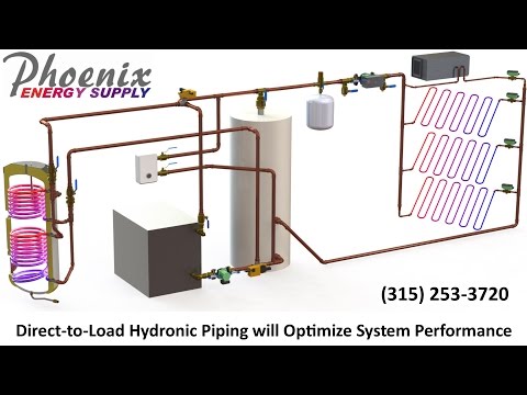

Yet another option that has advantage being promoted in the GEO industry outworks for hot also.
It's called the 3 pipe or direct-to-load" method. Promoted by engineer John Manning who specializes in GEO design. Proper buffering is critical with fixed speed heat pumps in zoned or small load systems, and the desire to drive efficiency with return temperatures.
I have installed 4 or 5 two pipe buffers now, several at my own place so i can watch them perform.
You need some resistance in the heat side piping. The small circ integral checks .35- .50 psi may not be enough check protection. A delta P or zone valve may be better.
If you have micro loads running a very tight ∆T, high flow rate, that low ∆ can cause some boiler short cycling as it reaches limit quickly. Low ∆ is more common in chilled water designs where this concept originated.
IF you assure a 15- 20∆ in your design 2 pipe works fine.
So with this 3 pipe the return must pass through the lower tank assuring some buffer always involved.
So it kinda depends on your system and goals, 2, 3, and 4 all have some pros and cons.
Here is John Manning presenting the direct to load 3 pipe concept in this video. He is GEO biased
https://www.youtube.com/watch?v=bFNIw_IrzYU&t=18s
