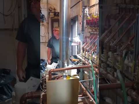

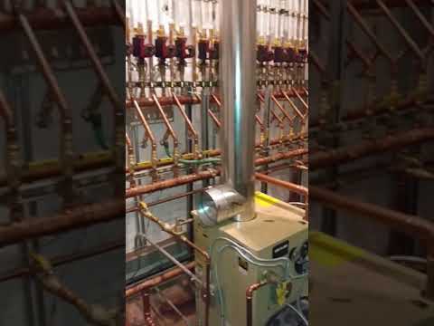

  • 15 circulators , 13 for risers and 2 for hydronic hot air handlers,not to mention the pumps in the primary and secondary manifold. Check out the YouTube video. We ran into a problem this weekend when we started it up so made video to send to our tekmar rep. Hopefully it's solved tomorrow.
    https://youtu.be/kl9FrhdswSs
  • Leon82
    Leon82 Posts: 681
    On the right there are 2 sets of close tees, is that the primary secondary merge? If I recall there is a minimum length of straight pipe called for. And it looks like there is an elbow very close to 3 of them.

  • Don't have piping diagram because we changed it. I do have this new YouTube video showing all the piping and pumps etc. Took it just for you guys!
    https://youtu.be/7VnP4BOWgZQ

  • Harvey Ramer
    Harvey Ramer Posts: 2,292
    The pump on the far right has to turn on whenever any of the 13 pumps on the header for the radiator risers turn on. This creates flow across the closely spaced tees where the take-offs to the three-way mixing valve are. The pump should be wired to the Tekmar 360 control on the System Pump outputs. It also must have the check valve installed.
    What model pump is it? It has to create flow equal to the combined flow in the Rad header.
