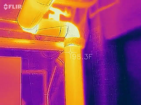

Shown here is a quick infrared video tour of the top the steam supply lines that feed the downward steam supplies in the Bromoseltzer Tower in Baltimore, Md.

    great tour, thanks. A high tech look at the color of steam.
    Why does the clock face show so warm, heated by the nearby steam lines?

    Beautiful! Thanks for sharing! Is this on districts steam or is there a boiler in the basement? I'm curiois, do you recall what the op pressure is and is this 2 pipe or 1 pipe? Just beautiful!

    @MilanD You are most welcome! This is a two pipe system. This is on district steam...please see my other Bromo video for a basement view.

    @hot rod : Those clock faces appear warm because it was a very warm sunny day. A great day to fire up an over-sized and under insulated steam system!

    Great video. It show the MEAN of Mean radiant temperature...

    In the video, the first main pipe you see is 4-1/2". Wrought iron (not steel). Installed in 1911.
    All Steamed Up tied a steel 4" riser from the basement onto the 4-1/2" pipe in 2007.
    The 4-1/2" riser starts about the 5th floor (where it used to be fed from the no-longer-existing factory). That riser expands, as it heats up, about 1.75 inches upward, inexorably, and so you can see the expansion loop in the video designed to accommodate this force.

    Gordo, have you used your FLIR to locate steam leaks?
    I have the very basic hand gun and can see steam wafting out of a leak. From the floor about 12' up. Invisible to the naked eye.
    Very slow and patience process, but there it was.
    That would be a neat video.

    An interesting use for the FLIR is to find and show to the customer hidden heating pipes under the floor and in the walls.

    Last season while just looking a 2 pipe orifice system with no traps on most of rads, this rad was it's 60% or so heat across as intended. But the FLIR gun showed the empty trap body glowing hot. This system usually has cool condensate returning.
    Going to the basement I could trace the hot/steam return pipe back to the next room that did have a failed trap and no orifice in valve.
    This would have gone unnoticed on this quick walk thru without the FLIR gun.
    Many uses.......not just seeing that the dog's heat signature left where he had been on the couch until I walked into the room. :)
