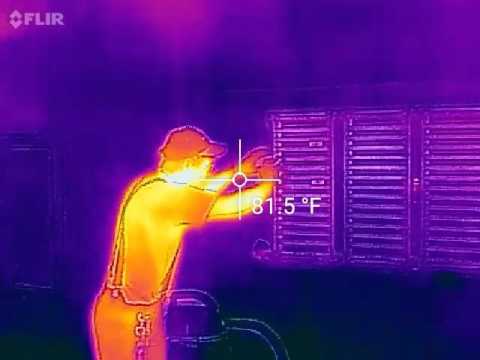

We installed this wall-hung radiator today. In order to save a bit of time getting the steam to it (and getting the new paint to out-gas odors quicker), we removed the vent and "sucked" the steam into the radiator while my son filmed it with a FLIR to capture a infrared video of the moment.
Notice that while under vacuum, the bottom connection to the radiator allowed water to be drawn up into the radiator from the wet return. A rough calculation of the induced vacuum applied appears to be in the order of 18" H2O.

Sweet. Someone likes his new Flir toy!
I was doing a steam monitor install today at Boston University. Brand new boiler room to me and no one knew where the traps were. I whipped out my FLIR and in 3 seconds knew where everything hot was located. Major time saver they are just a great invention.Peter Owens

This situation is very different than natural vacuum in a closed system. Here a large volume of air is continously flowing through the radiator into the shop vac coming mostly through the dry return creating the slightly lower pressure in the rad. The condensate is dragged back in with the fast moving air. There is no such air flow with natural vacuum and no condensate comes back in this way. Just pointing this out for anyone worrying about such things in trying natural vacuum.1926 1000EDR Mouat 2 pipe vapor system,1957 Bryant Boiler 463,000 BTU input, Natural vacuum operation with single solenoid vent, Custom PLC control0
