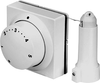

I'm trying to install a Danfoss thermostatic radiator valve on my single pipe steam system. I'm installing this at the air vent location. There are three parts I have for this setup....
1) 013G0140 - Danfoss Thermostatic Rad Valve / vac breaker
http://s3.supplyhouse.com/images/products/zoom/013g0140-3.jpg
2) 013L8011 - Danfoss 1 pipe steam air vent
3) 013G8562 - Danfoss Remote Setpoint & Sensor - Wall Mount
https://www.phwarehouse.com/product_images/s/492/Danfoss-013G8562-15150__65037.jpg
Its clear to me how the valve and air vent connect and how to install that on the rad (just replace existing air vent with this). I'm stuck on how to install the remote setpoint and sensor. The instructions included are not getting me there. Any advice on this setup?

    The gray cap on the 013G0140 should come off, and one of the remote sensors (actuator) should mount in its place.

    I think the grey cap comes off to accommodate the Thermostatic piece. The grey piece/knob is flow control.

    Got it, thanks. Now of course it all doesn't fit within the enclosure. The radiator enclosure is metal so its not so easy to make it hole. Been doing some reading and it seems like I can make use of another part: Angle Adapter for Snap-Lock Sensor SKU 013G1350 to make this all fit. Will report back later this week once I get the part and install.

    @LionA29 I will post a picture this weekend. I installed one this evening in a tight spot and it fit well. I used a different part than I mentioned earlier. SKU 013L8300, which is a 45 degree elbow for the RA 2000 Valve. I used 2 of these to create a 90 degree turn from the radiator which then fit the contraption easily alongside the radiator side instead of sticking straight out.
    I just installed and didn't get much time to test, but it seemed to at least prevent steam from reaching the radiator. I need to make sure tomorrow that it will still give steam when the temp is cold enough (or the setting dial is set high enough).
