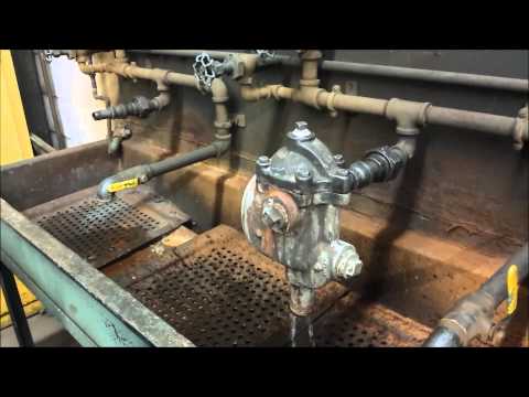

Warren Webster 0026-T "Drip Trap"..... Repair??
JUGHNE
JUGHNE Member Posts: 11,513
edited January 2017 in Strictly Steam
Are these true F&T's?
From what I have searched here I have not seen this 5 bolt design.
Most of these WW are not re-buildable as there are no floats available.
This is for a drip of a 4" express riser, 2 story 1949? schoolhouse.
Note: pictures too follow, if I can find them.

    Replace it. The cover bolts will likely break off if you try to get them out. Ask me how I know that :s
    Not sure if the center-to-center spacing of the pipe connections on a standard 6-bolt F&T trap (Sarco, B&J etc) is the same as on that old Webster. Measure them before you buy one. If the spacing is too large, get an inline trap.
    Maybe @Sailah can tell us what the spacing is on a B&J H-pattern F&T trap. We'll need to know what the pipe size is on the existing trap as well.

    Thanks, Steamhead;
    This F&T has a new gasket installed by previous repair people maybe 2 years ago. I don't know if they changed parts or just cleaned things out. The 2" drip pipe was not opened at that time, any of those I have opened after 60 years have been completely full of debris.
    I believe that floats are not available for these?? There are 3 more in the building. This particular one seems to be passing steam and sometimes then holding condensate back, eventually causing flooding of boiler.
    Is there any good logical reason why this F&T was put into this classroom?
    There is a huge boiler room directly on the other side of the wall of this classroom. There is at least a 8' drop to the condensate pump.
    I am thinking to bring the drip pipe of the 4" main thru the wall into the boiler room and drop down to eye level and install a new F&T.....maybe 3/4 instead of 1". Add strainer with blow down port and then test port after F&T in boiler room.
    Is there a maximum pipe distance the F&T can be from the actual drip connection of the main?

    I make an air vent for those but the floats are obsolete.
    Best solution I have is to use our 42T that mimics the piping arrangement. My pen in the inlet and you have your choice of outlets.
    Or you could use a 1" H pattern and repipe a little bit. 1" FT trap is 3 5/16" center to center on the inlet/outlet.

    Just for fun, we rebuilt a #026 with surplus OEM Webster internal float parts and sent it to B&J for testing.
    Please go to and subscribe to the Barnes and Jones YouTube channel and leave your comments on the page below.
    https://www.youtube.com/watch?v=0AHPBwyn2P8

    Thanks Gordo; this also showed up on the search function for this site.
    The one being tested is different than what I pictured above.
    Yours has a plug in the top center and only one tap in the bottom.
    Mine has the nameplate in top center and 2 1" plugs in the bottom. FWIW

    @JUGHNE : You are welcome. The #0026 (the one inch size) is a more rare overall and a bit more difficult to repair than the #026 (1-1/4" size) and the parts are much harder to find.
    It can take years to find those parts.
    The 5 cover bolts are the main issue. There is a 60% chance that one or more will break. That rises to near 100% if the old gasket has leaked and rust is visible. At least that part for you is not likely, as someone has replaced the old gasket. They might have even used anti-seize... maybe.
    We have a few we've been treating in our shop with a 50-50 mixture of acetone and ATF fluid waiting for the summer.
    Oh, it gets better!
    The first thing you are confronted with if you remove the cover is a cast iron cross bar and a 1/4" or so square-head set screw holding the cross bar and float assembly in place. That set screw must be loosened in order to remove it. It can break off. Yeah, fun.
    Once the cross bar has been wiggled out, then you can jiggle out the float ball and valve assembly. You will most likely find the seat and stem worn out. The part is OEM and made of mostly unattainium, as you found out.
    So, when you remove it and replace it, think about sending one or so to us for our petting zoo!

    Gordo, the ugly duckling has been removed. The 5 bolts came out, the top off, the square set screw came out (6 point socket with impact drill), Even both 1" nipples came out. All thanks to Kroil spray and bench vise.
    The float looks intact, can hear what sounds like buckshot inside,
    it seems to be buoyant it that it does not immediately sink in water.
    Where do you want it sent? Or it will become 13.6 pounds of scrap someday for someone.
    Note: or better yet maybe Peter will give me some trade-in allowance for a 1" H pattern as the F&T is to be relocated into the boiler room. ;)
