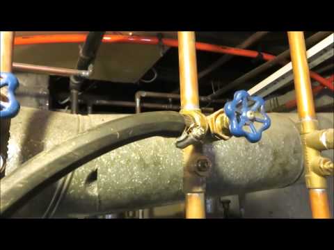

  • GW
    GW Member Posts: 5,137
    Ah shoot it's very easy to do but very hard to explain, post some pics from 10 feet away and I'll try to explain.

  • BornForDying
    BornForDying Member Posts: 40
    Lots of videos available online that show how to purge zones. As others have said, post some pics of your valving and we can help if you're not sure.
    https://youtu.be/KZI7_UJI5LM
