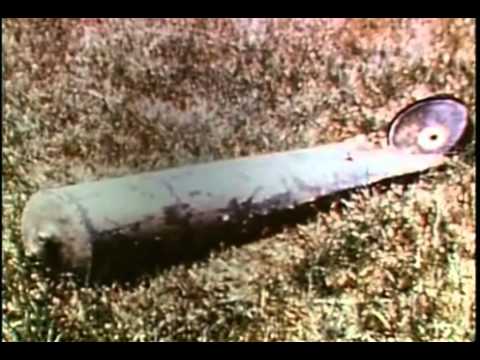

There was a film (actually film) produced by the (I believe) Watts company who at the time was promoting the P&T relief valve for common water heaters.
They would set up the common 40/50 gallon water heater in a mock 10 X 10 house. House was as well built as most houses were, stouter than today actually.
The tank was full of water, valves off, no P&T relief valve. The controls were bypassed so the element was constantly on. After several hours the tank ruptured by pressure produced by water expansion, this allowed the superheated water to flash to steam as the pressure in the tank dropped . The tank took off thru the roof, the house was demolished. This was filmed by people in bunkers about 200' away.
The entire presentation was well done and very memorable.
It should be shown as a public service announcement, though it would have to be shortened as attention spans have dwindled.
I saw this at a trade show maybe 35 years ago...it was older than that....probably made in the 60's. Would be a good Utube for today, if anyone could find it.0 -

Yes, much better. The one I saw might have been a little newer. As the guy with the pick-axe puncturing the cold high pressure tank had to wear a safety suit, heavy rubber with face protector. (The beginning of OSHA ).
I was a mere electrician at the time and knew I had to get diverse enough out here to stay above water. That is why I was at a plumbing trade show. For me this was very enlightening at the time. It introduced me to the power of steam which sparked enough interest to get me to the Wall today. There are still some water heaters with a pressure relief valve only. People don't realize the potential inside their tank. You see plugs in P&T valves on occasion because of dripping.
The newer version of this presentation (60's) was made because there were so many plumbers who said "we don't really to put your P&T relief valves on anymore.....there haven't been hardly any tank explosions.....do we still need them"!!
