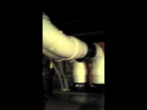

My brand new boiler is making the same noise as in this video anyone know the fix
https://www.youtube.com/watch?v=dstGyZThNqk
BTW it a weil mcleain0
No codes?0
Agree with @rick in Alaska . Do it before the fan is toast.0
It can only be the inducer (fan). Probably a problem with how the casing is secured.Contact John "JohnNY" Cataneo, NYC Master Plumber, Lic 1784

Thanks all for the feed back. We just opened it up and checked the fan. Any other suggestions.
This tends to happen in Zone 3 and Zone 4 after we turn the heat up it does not happen all the time. Right after the noise stops I hear water circulating in the system.
Could it be not enough water getting to machine or gas?
Thanks again !0 -
What is the system psi gauge reading?0
from 12 - 150
Bump it up to 180
Put your hand over the fan inlet slightly to see if it the noise changes any its either the fan or pump flow0
Thanks all for the feedback. I reached out to Weil Mclain's Tech support today and they asked if our exhaust run was long or short. We told him 4 ft - he stated that was short & we are getting to much air to the boiler. We were told to put in part # 383700235 to stop the noise
This info is not in the manual just came up recently and no charge for part. You must reach out to distributor1 -
