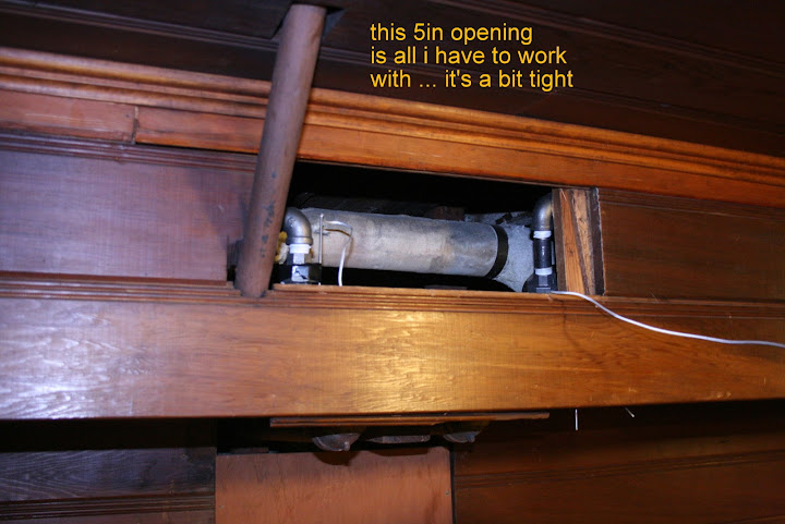

    vent placement quandry...
    it's a good question that I have been trying to work through .. what are the pros and cons of vent placement provided they are at least past the last rad riser ...
    in theory you don't necessarily want to fill the "extra" main pipes since you would be losing heat and adding pick-up factor. the condensate WILL go where air is, so that's not an issue. placing the rads near the last rad riser also allows you to come to pressure earlier and therefore decreases burn time.
    i'd love to hear the opinions of others.
    i think in general dead men designed systems that didn't have this as a problem necessarily and were able to place vents between last rad and drop to wet return without a significant amount of leftover overhead piping. i think I remember reading that it was during the "conversion to oil" era that "single loop main systems" were split into 2 separate loops that many of us now have.
    in my system, i have a split loop (front and back) which both drop past their last rad almost immediately to a common wet return. i had little choice in vent placement, and just barely enough room between the last rad and the elbow which drops wet.
