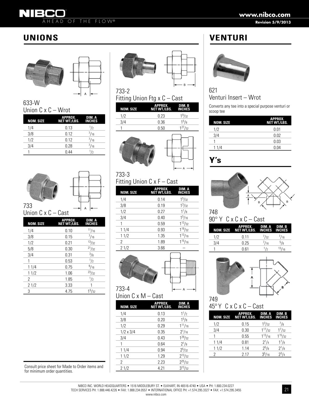

    More than one way to venturi...
    including the venturi fitting made by Nibco. Like this http://img.directindustry.com/pdf/repository_di/12637/copper-fitting-catalog-123275_21b.jpg
    In addition to this fitting, there is also something called a scoop fitting. As the name describes, it is shaped like a scoop, and diverts flow accordingly. Like this http://www.accentshopping.com/ImageGen.ashx?IMG_ID=9654&IMG_Height=250&IMG_Width=250
    Just because it doesn't look like an official Mono-Flo tee, doesn't mean it can't make a difference. Had to be SOMTHING in there to cause the system to work.... Gravity?
