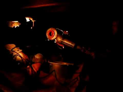

We Installed a Wooden Path...
...for 150 ft from the entrance of the crawl space to the work site in order to move in our tools and machinery.
We cut the pipe and removed the failed section.
The Ridgid #141 was hauled into place and the cut pipe end was threaded in situ.
A new section of pipe was cut and threaded to match and bolted into place...
...and it is ready to last another 100 years...
To Learn More About This Professional, Click Here to Visit Their Ad in "Find A Professional"0 -
And here's a video
of us actually running the 141 with the 700:
http://www.youtube.com/watch?v=WobEWDE5D8w

what method did you use to cut & remove old thread & pipe. was welding an option ? last time i made thread in place like that was late sixties.------no 700 ... hand ratchet. flanges look beautiful.0 -
We cut out
roughly 30 inches of the original pipe in two steps- one in the middle of the span between two fittings and one about 2" from the tee, where the leak was. Then we cut out a "keystone" piece from the stub left in the tee, which allowed us to spin the stub out of the tee. The leak turned out to be in the root of a thread. Then we screwed a short nipple into the tee, threaded the cut end of the existing pipe, mounted the flanges, dragged the 700 and 141 back out to the PRV room to cut and thread the new piece and mount the flanges to it, went back into the crawlspace and put everything together.
Sounds simple, but for those who have never done this, the crawlspace location made it go very slowly. You just can't move quickly in such limited space.

cutting
Great work guy's and a cool video, What did you use to cut the existing 4" that was threaded? Porta Band, or a sawzall?0 -
For the first cut
which had to be square, we used the big Ridgid 4-wheel cutter. The second cut was not critical so we used the Sawzall.

Thanks, Guys
For all the comments!
Yes, welding was an option, but...
1) 350+ feet of cable would be needed to get from the truck to the site.
2) Risk of fire. The building just survived the Great Baltimore Fire of 1904. We don't want to go there.
3) Our usual welder didn't return our calls about this job. Small wonder.
The Ridgid 700 makes things a lot easier with the 141! We ran a 10gage 100 ft extension cord to keep the voltage drop low.
You all have my respect for using the 141 with just a ratchet.
