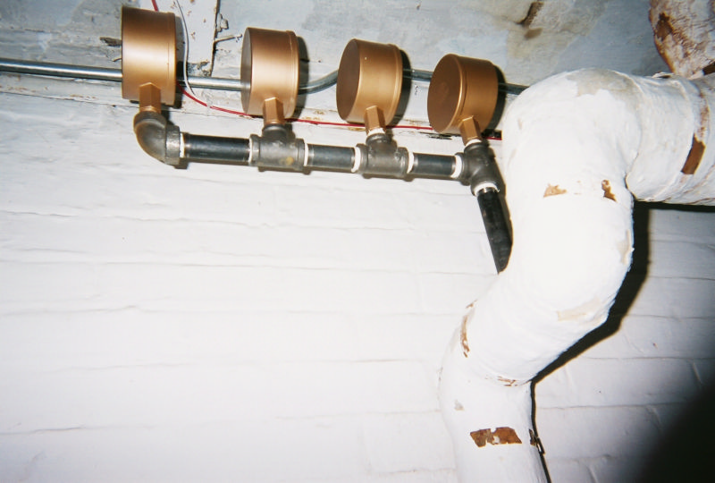

See this post for pics of piping:
http://forums.invision.net/Thread.cfm?CFApp=2&&Message_ID=426480&_#Message4264800 -

Go back to the post that has your pictures0 -
Lance-
Go back to the post that has your pictures and read back in that thread to a reply from me about your boiler piping and the suggestion that you probably need to use the other steam port in your boiler.
I have attached a picture of what might be called "the ideal header". I save pictures like these for further reference. I'm afraid I don't remember who did it. I tried to look back and find the thread. It was one of the steam pros on this board. Beautiful work! Also notice how the risers, from the header to the main, are angled so that any condensate drains back easily.0 -
No, this is not the problem. With the shutoff valve fully open and no radiator connected, water and steam come out of the valve opening at exactly the same time.
Remember, I have this "vent spitting steam" problem on most of my radiators (3rd floor excluded -- maybe the water isn't being pushed up that high? as well as some radiators with old vents -- the vents also don't let much air out so I think they need to be replaced anyway).0 -
Yes, I did note that. However, I thought using both steam ports would be ideal but probably not causing the problem I'm having.
The problem is that we just moved in and I don't know who installed it and I don't know of anyone in the area that is good with steam. I've used the search on this site, but there are no ads in my area.
thanks
The pictures of your near boiler piping show that you don't have any pipe insulation. A steam pipe that isn't insulated looses 5 times as much heat as an insulated one. The steam in an uninsulated pipe condenses the steam creating a lot of condensate and possible more condensate than the pipes can handle.
If you haven't insulated your steam pipes you need to do that with a least 1" fiberglass insulation.
Also do you have a counterflow steam system of a parallel flow steam system? In a counterflow system the mains pitch back toward the boiler header, in a parallel flow system the mains pitch away from the header and there would be a smaller return line connected at the end to return condensate back to the boiler.0
