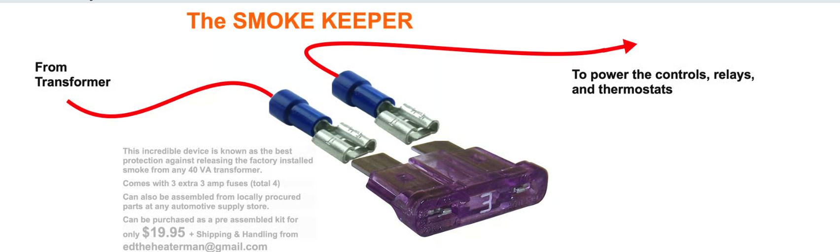

    Another clue is the fact that a transformer needed to be replaced and wiring needed to be replaced. That tells me that there may be a low voltage wiring problem. if the three transformers (zone valve transformer, SR501 transformer and the Weil McLain boiler transformer) are not isolated as I have shown in the diagram above then you will keep using up the factory installed smoke inside the transformers until that incorrect wiring is corrected.
    Until then perhaps they can install my world famous "Smoke Keeper" so the current transformers don't loose their factory installed smoke.
    You don't need to purchase this from me. Just pick up the necessary parts at the auto store.
