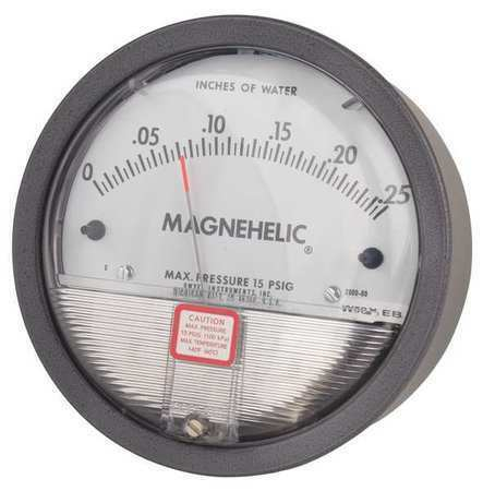

Is there a model suited to measure draft of an oil boiler?
Ideally the scale should read Zero to -.05 inches of water.

    The gauges I see on ebay - none of the needles are on zero.
    Shouldn't they be or would the gauge have to zeroed depending where it is located (relative to sea level)?
    The magnahelics have a zeroing screw so set them to zero after installation. In eBay photos who knows what way they are oriented and that can have a large effect on a low pressure gauge.

    EBEBRATT-Ed Member Posts: 13,851
    Yes, you turn the zeroing screw. It's not uncommon to have to do that especially on the low-pressure gauges. The #460 however will never lie to you. Not as convenient because you have to use fluid, but nothing ever goes wrong with them. Most of the Dwyer's you have to use Dwyer's colored fluid which does have a different specific gravity than water and the manometer is calibrated for that fluid, so you have to use it. That being said the Magnehelics are pretty rugged.

    This one is my favorite, but they are discontinued. They are big, sturdy, and accurate. You can find these Bacharach MZF gauges on ebay with some careful shopping, sometimes as part of the Bacharach combustion wet kit. Bacharach also makes a pocket draft gauge but that of course can't be permanently installed like the MZF can.
    This one isn't marked, but the negative side is to the right of zero if you were wondering. The needle swings around zero depending on how the gauge is leveled, but just place it on top of any flat surface and move the adjustment lever on the right side.
