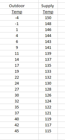

    Here's my reset curve (1800 SQ ft house, Long Island) which has worked for two winters. I only had to adjust it last Jan when we had that week of single digit and zero deg days.
    Of course your's will be different, but it will give you an idea of what's possible. The goal with a mod-con is to keep the return temps below 130F as often as possible to enable condensing and high efficiency.

    Thank you for the reset curve, that looks like a great starting point!

    ^ only thing I can offer is to advise you to look at the condensing chart above and shoot for return water temps on the primary side that will keep you in condensing range. Once your RWT is over 130F you're not condensing.

    I don’t believe I have the “select your delta-t” feature/control on my system or I may have just skipped that part in the manual since my boiler pump isn’t variable speed.
    I set each zone pump to give me 3-GPM flow (if memory serves I could select 1 through 4 GPM) as that is the middle of the recommended hydronic flow range for ¾” copper. Not very scientific, but I’m not even sure if the reported flow rate is accurate.
    Adjusting the boiler pump flow was more difficult as its just downstream from the low-loss header (no back pressure). The least amount of flow I could select was 7-GPM (max was in the low teens).
    Thus, when all three zones are active (which is 95% of the time when very COLD!) system flow is 9-GPM w/boiler of 7-GPM. Yes, I’m “eating” some boiler water when two zones are active and lots, when only one is, but by the time only one zone runs it’s pretty warm outside so that even the boiler outlet water is well below condensing values.
    I envy your 10:1 turndown ratio as I only have 5:1 and need to play games in order to minimize short-cycling. In hindsight, the next smallest model (WHN085) with a 50-gallon indirect tank would have been a better fit.

    To get the most efficiency the system side flow should always be more than the boiler side flow to get the lowest possible return temps to the boiler, always. In a HE, P/S,setup. I use the P/S as anything that decouples two seperate flow rates from system side, and boiler side.
    Once the ODR is tuned to its maximum performance, that’s it that’s all you can do to get the highest performance out of a condensing boiler with a system as is.
    The only other thing is change style of emitter, or increasing emitter surface area.

    There is one other thing you can do. That is keep your firing rate as low as possible for as long as possible. If you look at the charts I posted you’ll see what I mean. So long as you don’t sacrifice comfort.

    And you may find that constrained delta operation and ODR may not play together well. I'm not a fan of constraining the distribution ∆.
    Delta is a result of what the heat emitters are and want to do, striving for thermal equilibrium. Delta T can and should vary based on ever varying loads.
    Forcing a ∆ is basically turn the system into an injection mixing concept. I'd rather a smooth consistent flow and modulate SWT with ODR. One mans opinion :)
    Ideally constant flow with modulating temperature and maybe TRVs as the individual control. This is the most common Euro control logic for ultimate comfort and efficiency.
    The rational behind the opinion here.
