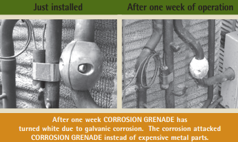

I saw from a pop up add on utube or fb, from supplyhouse, sacrifical anodes. Grenades?
It was the kind that clamp on the outside of a 3/4" copper water pipe it looked like.
It reminded me of zincs on boat prop shafts when I saw the picture in the ad on line.
I have never seen a zinc like that on a home heating system water pipe - i would remember and go hmmm being a boat person.
when/where/why use something like that on residential water pipes?

    I happened to find it at supplyhouse...
    The Corrosion Grenade by A/C Zincs, Inc. provides a proven solution for extending the life of the air conditioning system’s aluminum fins. This deterioration is due to exposure to coastal environments. Economical and easy to install, the Corrosion Grenade sacrificial anodes are an adaptation of a marine application for fighting galvanic corrosion. This is a truly green solution to a costly problem.
    https://www.supplyhouse.com/AC-Zincs-ACZ-3-8-3-8-Zinc-Corrosion-Grenade
    I'm not on the coast, there is no salt air, no aluminum - what would have caused the corrosion and pin hole leak that developed that I described above? solder flux not wiped off when installed and left for 20+ years?

    Hi, For a sacrificial anode to work, there must be an electrolyte between the different metals. If there is no water, how is current conducted? The grenade sounds like a great idea for an underwater line. I see no benefit if it's dry.
    Yours, Larry

    Hi, Looking at the link, and flyer, the purpose of this grenade is to protect aluminum. Maybe the ideas is that this thing sits out in the rain and the slowly corroding zinc is washed down onto the aluminum fins, protecting them. Maybe it's like the old trick for keeping moss off the roof by having galvanized steel flashing up on the ridge. The zinc washes down and prevents moss growth. Still, zinc isn't much less noble than aluminum on the galvanic scale. Magnesium would be a better choice if this approach really work. I'm not seeing any claim for protecting copper pipe. They specifically say that it doesn't. :|
    Yours, Larry
    Has anyone seen, or known about, aluminum fins of an air conditioning system deteriorating?

    Some guy just came up with the idea to market it for use on condensers
    Been around a long time as a boat shaft anode.
    Funny how they use a black and white photo in all their brochures for their before/after to hide the fact the condenser fins are probably just as white.

    http://corrosiongrenade.com/
    Economical and easy to install, the Corrosion Grenade® sacrificial anodes are an adaptation of a marine application for fighting galvanic corrosion.
    such a thing will only work regarding galvanic corrosion. It will not work for salt air corroding aluminum AC fins via oxidation or any other mechanism of corrosion.
    Got to hand it to them though, every part of their statement is true.
