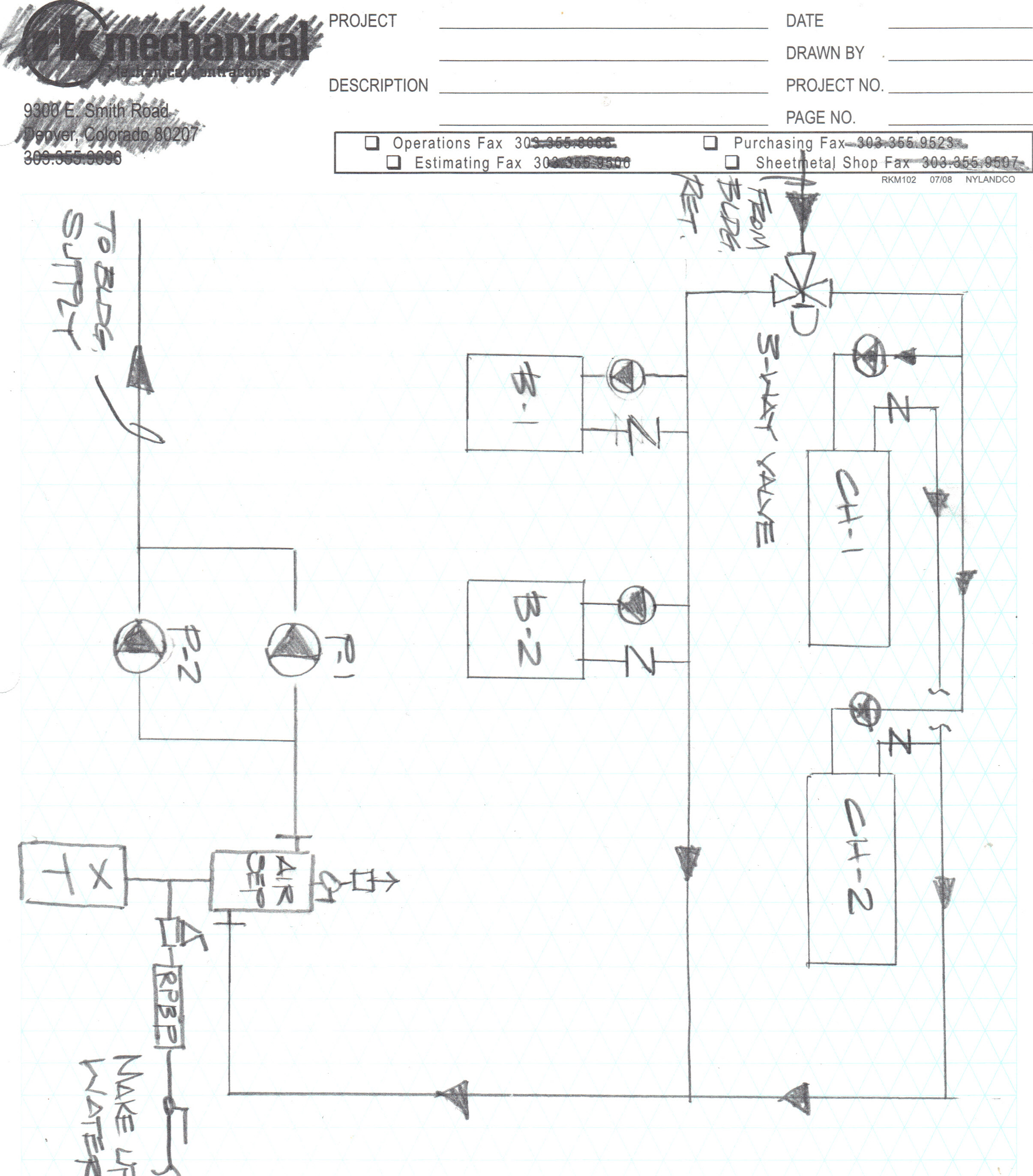

does this system look right?
pipeking
Member Posts: 252
I am doing the plumbing on this job, it's a 3 story 200+ private rooms for senior living (very elegant). another company is doing the heating and cooling system, and I have some problems with the way boiler room has been piped. I haven't said anything to anyone, but it's just not how I would have done it. here are some pics and a diagram. I left some thing out of the diagram like, sensors, valves, isolators, but the fundamentals are there. take a look then I will give my 2 cents on it.
"Piping by others"

IF the system is piped like your diagram then it IS piped wrong.
First why have a hydraulic separator and not use it. The boilers need to be piped directly to one side of the Hyd Sep and the system gets piped to the other.
Also the domestic hot water indirect loop must be tied into the boiler loop supply line before the Hyd Sep so it receives the hottest water possible.

these are my issues
oh yea, how have u guy been!? I know it been a while! :}
I know the pics are hard to follow, but the diagram I drew is exactly how the primary/sec piping is set up. so with the closely spaced tees not closely spaced, and an elbow in-between, and the differential by-pass in-between, was the elephant in the room. I don't think the hydraulic separator is a tru separator, its just an air separator with a strainer. the whole job was vic, and I'm ok with the boiler room being vic its just a lot of feild work. at the end of the secondary loop it is not "looped" together but there is are differential pressure sensors for the by-pass in the boiler room. there r no 3 duty cuz of the VFD's, just suction diffusers and checks. I do like the way the pumps r hung above the boiler and the stanch the built for the chiller pumps. the circuit setters on the primary I don't get, shouldn't the pumps be sized accordingly (thinking the only reason they r there cuz the pumps could be to big).I will try to get a pic of the print to see what's what.
also the engineer has circuit setters on my domestic hot water mixing valve too. I have never seen that before! there r a few water heaters that don't have a recerc line or anything fancy: just a hot water heater and a thermostatic mixing valve (symmons 400&500) and the print shows a circuit setter on the cold water inlet of the mixing valve. It's been a while since I read the literature on these bigger mixing valves so I opened it up (3 pages wow) and there ain't nothing in there, or water heater's literature about that; like I said never seen that before.0 -

If that is a roll a troll or equal then the piping still isn't right.. Then the boiler loop needs to be piped primary / secondary with closely spaced tee's - not spread apart like in the diagram. And the indirect still needs to come off of the boiler supply pipe before it goes to the main.0 -

I would have piped the chilled water primary / secondary also. But the tee's for the chilled water would have been after the boiler tee's - less cold water induced into the boiler loop even with the spring checks.0 -

This system is piped completely wrong.
-no point of no pressure change.
- boilers are piped in a way that their pumps are pumping into itself. i do not see system pumps
- differential pressure bypass is in wrong place.
and so on

To the original poster, to their credit, the engineers may have drawn it correctly, but due to space limitations, the installer did not meet their intent. Without seeing the engineers drawings it is impossible to say. Regardless, this system is going to have a lot of problems.
Due to the fact that they put extra pipe and fittings between the two secondary tees, you will experience flow through the chillers and boilers even when they are in the OFF position.
Also, if you have a VFD, and a properly applied pressure differential SENSOR, that is controlling the pumps, then you DON"T want a pressure differential bypass controller anywhere in the circuit. The pumps will see the bypass as a "hole" in the system and will run at a significantly higher speed trying to fill this hole in.
This is not rocket science, but you do have to pay attention to detail in order for things to get along, and play well together. WIth it being a 2 pipe system, it is obvious that you will either be in heating mode, neutral or cooling mode, but never both heating and cooling mode. That may not work well for your building, depending upon the buildings use, solar exposure, internal gains, etc.

Due to the fact that they put fittings and pipe between the two secondary tees, and the boilers are piped in parallel, you WILL have flow though the boilers and the chillers, even when their respective pumps are in the off position.
Secondary tees MUST be as close to each other as possible to avoid creating a pressure differential between the tees.
There are also some basic rules of straight pipe before and after take off tees, but not nearly as critical as the need to make certain that the tees are as close to each other as possible.
And then there's the "hole" in the system being caused by the pressure differential bypass control valve… Might as well not even have the variable speed pumps…

Generally speaking, 2 pipes system MUST have a "neutral" position to allow the chilled or hot water a chance to dissipate their heated or cooled fluids prior to starting either the chillers or the boilers. Otherwise, you may cause some serious damage to the equipment.

There are no less than 100 ways for different people to pipe the same system. Here;s my idea of ultimate simplicity. Numerous valves and the expansion tanks are missing because the old PC decided to throw up on itself right near the end of the drawing, but I think you'll get the gist.

A version for critique
I am a huge fan of 'first in, last out' with multiple pieces of equipment. Not a huge fan of 3-way valves though, as all the old apartments in Denver I see them in they are essentially manual only and not reliable. This drawing shows what I take the parameters were with this job. I am more used to separate expansion tanks and system pumps, but that all adds cost. Also, I do not currently work for who made the iso pad I just used. If it is too close to advertising let me know. Tried to cover it.0
