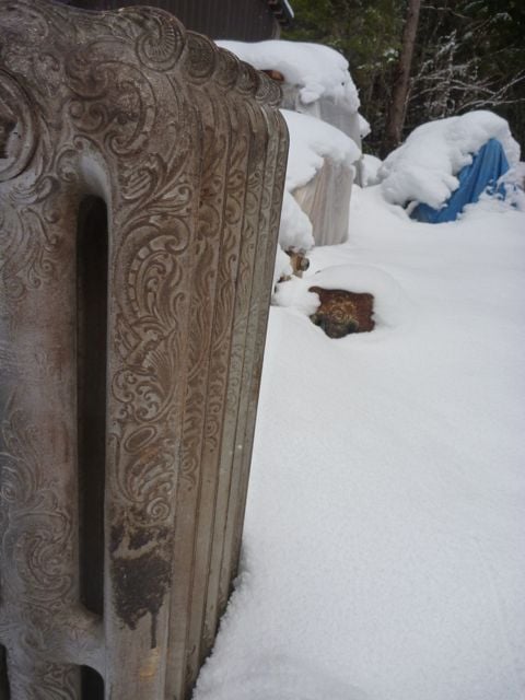

I couldn't resist....
Gwen Healy - Radiator Ranger
Wow...
Looks like Breitenbush is getting all the snow that the Colorado mountains are missing.
Last I checked (2 weeks ago) I had a total of 6" on the ground, where I usually have 2' on the ground at this time of the year. Then again, on this side of the Continental Divide, we are ABOVE average for snowfall for the year, and just heading into our snowiest month.
Whacky weather for sure.
Beautiful pictures...
So, when are you going to write a book about radiator restoration? :-)

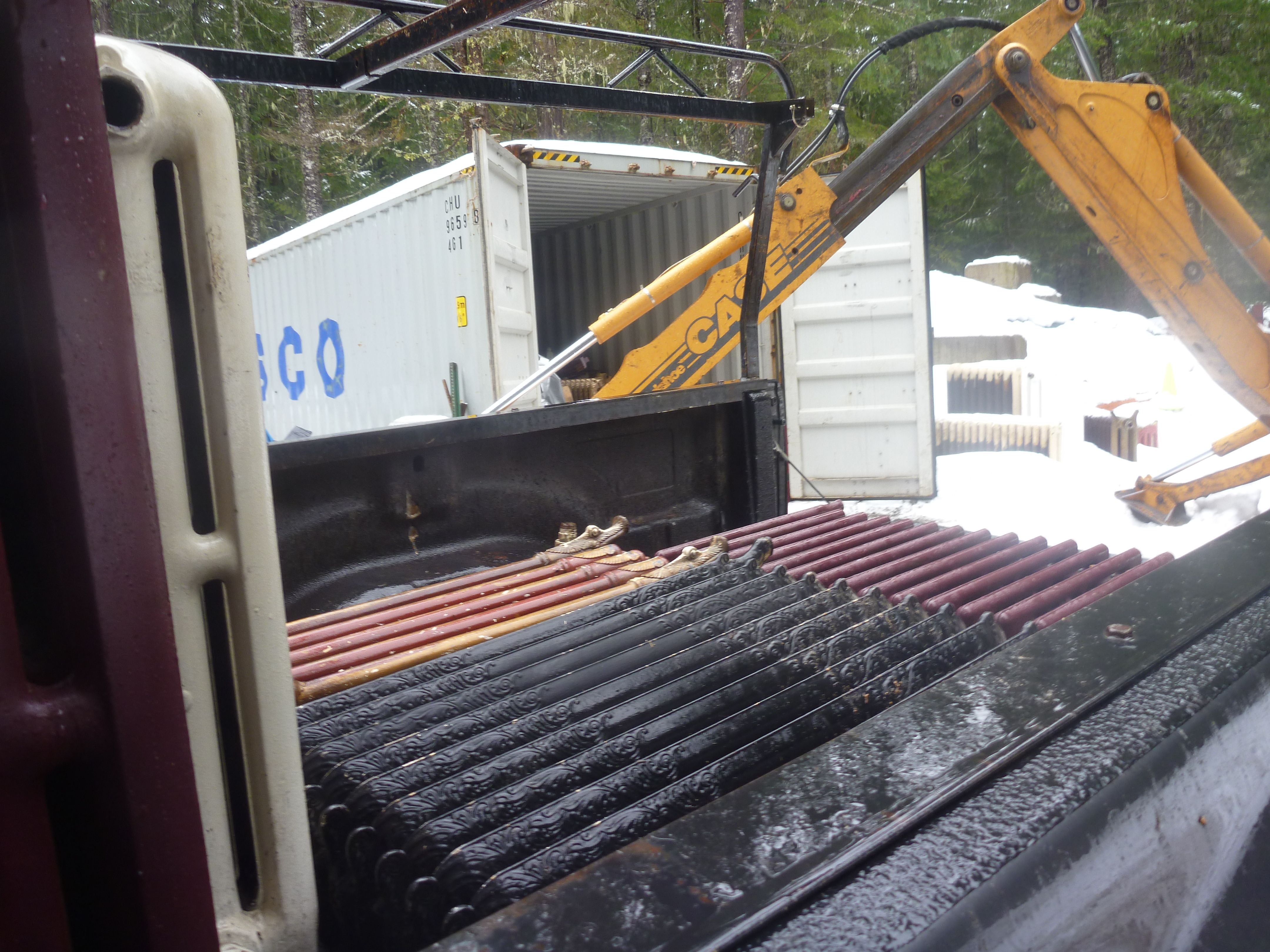

Of course, not everyone has a Case 580 backhoe sitting around in their yard.

We've been getting snow in fits and starts. Never much at a time but when I look at the overall accumulation we've don'e okay here this year. I think we've got enough snowpack to limit the fire danger and to fill Lake Detroit for grid hydroelectricity and summer recreation which is important for the local economics.
I hadn't thought to write a book about restoring radiators. If I did it would have a lot of pictures. I just love looking at those things, thinking about em' and how they ever came into existence and then getting them plugged in... I am developing an aversion to loading them at the pick-up end, but having that backhoe and hook make unloading pretty manageable.
I'm attaching a picture of a set of radiators that have been unplugged for years and that we recent'y 'refurbished'. These represent our oldest, ornate units. The middle one (with the triangles) say New York something (maybe radiator), the one on the left is from a building that was under construction in 1893. Lucky for me things things have a very long shelf life.

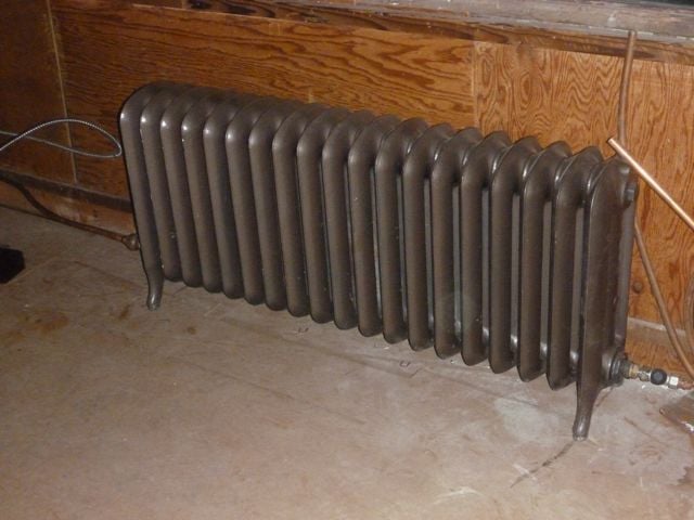

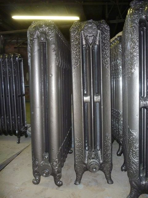

Once in A while I refinish a radiator here or there. What are you using to for the actual paint?
If that's proprietary info, I'm okay with that.
I've asked around, but I've never gotten a strait answer as to the best paint to use. I know the new ones just come with gray primer, and I've been told that the originally there was no finish on some of the old ones.
I've had good luck with high temp engine paint (found a pearl gray which has a finish similar to what I see in the photo), but that can be expensive on some of the bigger radiators.0 -

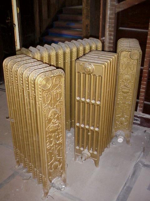

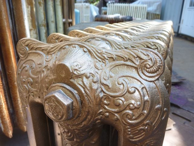

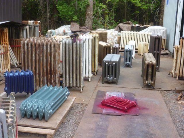

Hi -
If I'm painting the radiator myself I use a flat black primer then spray with a color.
Rustoleum holds well if the surface is clean / sound and there are a lot of colors!
Spraypainting works well but you can also use pourable paint and a small roller....
The hammerite finishes are nice, the last picture shows a set of radiators we had sandblasted and painted a color based on the bronze hammerite spraypaint. This does cost more than hand spraying.
The pearl gray sounds like a nice color. Do you have any pictures?
We have an issue with off gassing radiators after painting - it can take a week or more.
The best paint to use is probably what they referring to on page 158 of my 1911 copy of The Ideal Fitter where it says of their bronze powder:
"...exactly suited to the decorating of AMERICAN Radiators. It lusters like loosened gold...
We earnestly believe that the use of a superior bronze in the decorative treatment of radiators adds greatly to the popularity of heating apparatus among home-lovers."
There was also a line of Ideal Radiator Enamels and you could send for color cards. I'd like to try Bronze Green, Maroon and Medium blue. Also listed are Green Apple, Silver Gray, Goblin, Nile Green, Sea Green.
Does anyone else out there know about these old finishes or painting radiators?
What's a big radiator?
I'll attach some pictures of painting in process, gold hammerite, a radiator maybe treated with the bronze powder and one more sprayed a brown hammerite.

Paint Formula
Hi FF15,
The specific paint mixed for that job was done at a NAPA auto store using a Sherwin Williams paint and a prism mixer or mixer. The color is based on a hammerite rustoleum bronze sample. I spoke with the paint mixer this morning and he said it'd probably be easiest to have someone that has the paints, etc. call him directly to get the mix formula. As much as I like the color I'm ready to try other colors.
I should say that radiators painted before 1978 may / probably have lead based paint on them. It's important to contain this debris so it doesn't impact people or woodland/ water creatures.

Surface treatment
If the surface is sound I wash it with dawn and cold water with pretty good pressure. Sometimes there is a lot of dust between the fins at the bottom that all gets blown out then I prime and paint. This has worked really well on a lot of rads.
We've had the ornate ones sandblasted then painted in batches.
What color will you paint them?
